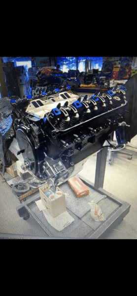

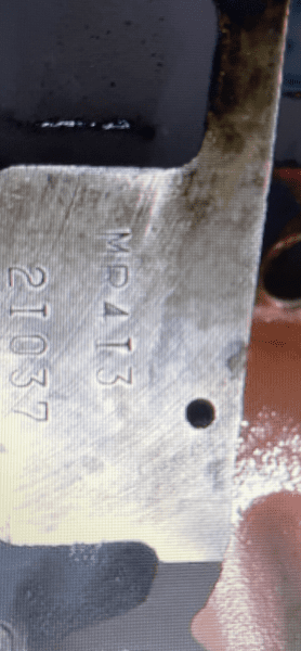

I have a 413
PAD Looks like MP or MR 413
Block Casting # 1851 629 6
Weren’t the Maxies In the 1851 Casting
Number Range ?
I’m guessing this is a 1959 casting ?
Maybe a Chrysler 300 Spec?
What Say You Oh Great Kreskin Of The
Land Of Mopar ?
Trying to get a more specific description.
Appreciate & thanks to All !
Mopar2ya!
John

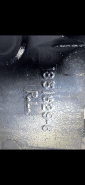

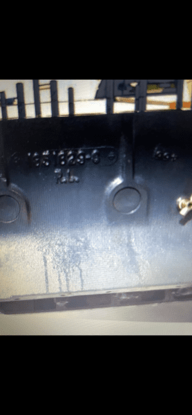

I have a 413
Number Range ?
Land Of Mopar ?
Mopar2ya!
John
Hi John, If memory serves me right the M is 1959, the P is premium fuel (HP), if it's an R it would be regular fuel. The 1962 M/W block was 1852029. I'm not an expert but I think that's correct.
Regards, Grant
That is a tough one. I can't find that being a casting number on any block. What is the date of the casting?
Good Question!
I need to check this beauty out more ….
I see references on 440Source on block
Serial number & sequences of years of manufacturing.
The refrence of “1851 “ is assigned to the
Max Wedge & Truck late 50’s & early sixties .
But does not expound on Maxie numbers Which were very low & now about 65 years
Past ….
Needs further inquiry!
Where’s Sherlock Whrn Ya Need Him !
Mopar2ya Bro !
Thanks !!
John
That is a 1961 casting number. R is the year call out. I have seen Canadian production stampings ( with the bottom row) like your picture.
I didn't think the third digit of the displacement was added until 1965??
If it was a MW block it would have cylinder notches for the valves
Didn't Maxie blocks have AAQA on them, denoting higher nickel content in the casting?
I can't believe none of us have a description to match that casting number.
The book I have lists casting #: 1852029 as 1962 Max Performance & Truck.
