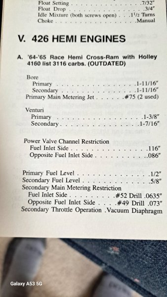

I found this in an older engine manual. Should help you base line the carbs. There's several fairly radical "upgrades " folks do to them that would hurt street ability.
