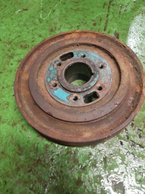

You might want to share a picture of your converter and harmonic balancer to help sort out what you have and make sure things are balanced. I may not be able to tell if its correct..but I would bet several members would. I understand you may be switching converter anyway. But I am curious at this point as to what someone put together. Are you going to do any things to the heads? Or are they going back on stock? 516 heads have been talked about in several threads recently.
Unfortunately I don’t have any pictures of them and I’m away from my workshop for a day or two. Like I said in an earlier post the flex plate looked like it was chewed on by a dog so I’d say the whole thing was thrown together

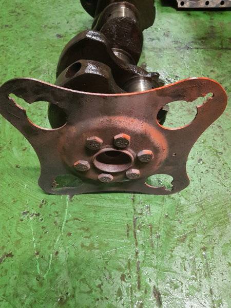

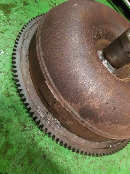

So here is a few snaps I took in my workshop today. Haven't been able to get over for the last few days due to heavy rain and floods. Check out the flex plate. Someone went crazy burning the holes into slots to make it fit the torque converter
Dampner looks right to me for forged crank. If the torque converter has weights for a cast crank engine they would be on the front side. The weight you can see in the picture is probably for balancing the converter itself. It looks like a 10.5 converter for a truck or a aftermarket one. Probably a 2200 stall would be my guess...doesn't matter if your switching it anway.
Impressive hack job on the flex plate. Lol
I couldn't believe it that someone spent all that money on a new torque converter and then butchered the flex plate. It's for that reason that I stripped the motor knowing that someone else had already been inside.
