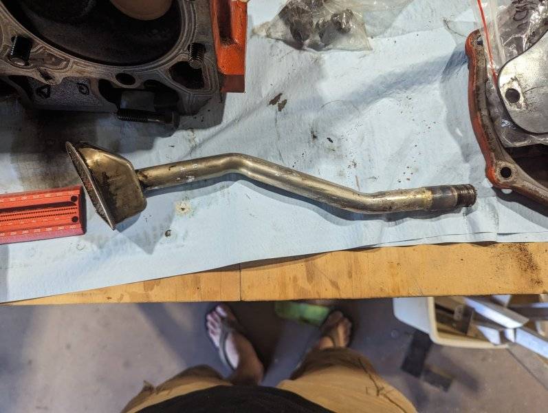

The oil pick up was a dog to get out. Is that a standard pick up?
Also the crank has a 69 stamped on it. Is that. Date stamp?
Not a stock oil pickup, idb. Someone will buy that steel crank.

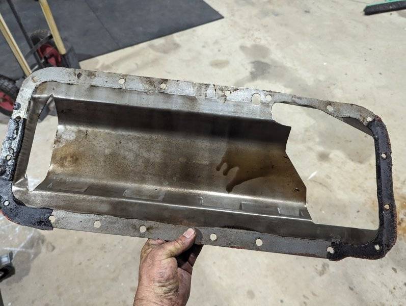

Going with a stroker, the windage tray may have clearance issues but the rest of the tin can be re-used if your going for the "it's stock" look. Obviously you need to keep and re-use all the front accessory components/brackets. All other wear items will/should be replaced since your going all out with a stroker. Good luck with your build :thumbsup:

The pan has a big dent in the front section unfortunately.
