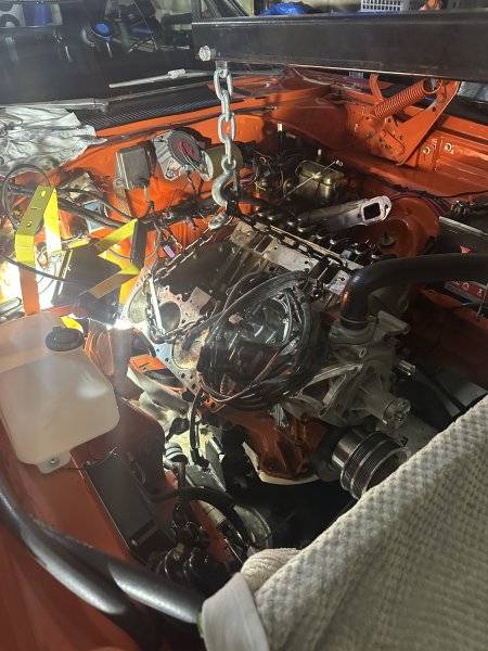

440 engine rear down. Anything worth keeping?
The crankshaft in your pics is a casting not a forging. The 69 is cast into it.
Probably has external counterweights on the damper and torque converter.
Make sure you have the right parts when the engine is balanced or it will vibrate badly.
Just use your original main caps.
That's a forged steel crank all day long. The "69" is a stamping, not a casting mark. Plus, the wide parting line is a giveaway.

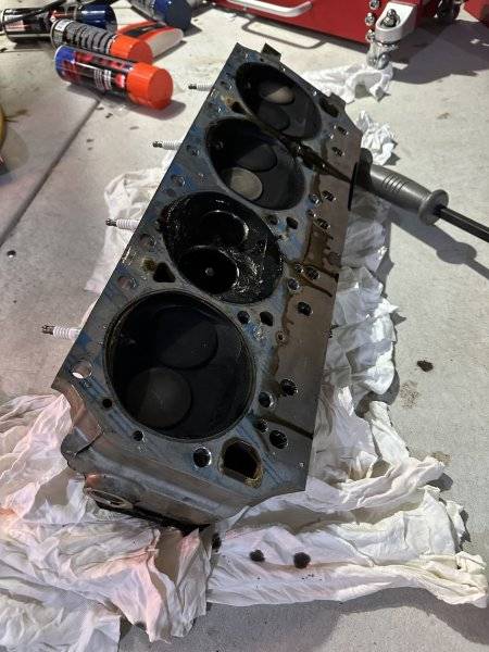

The reciprocating assembly and heads have some value. I would rather sell them to someone who needs them than sell them for scrap…

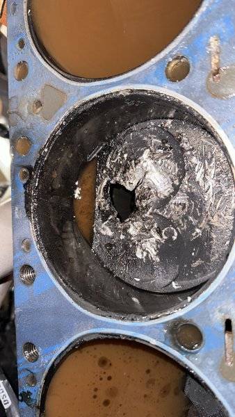

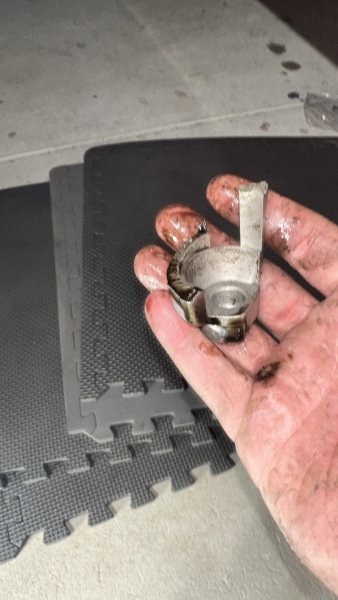

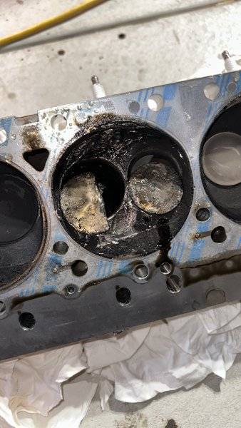

What happened?
Oh cool, I lived up in Broome for a few years while I worked in the Pilbara, back over in QLD now.
What happened?
Looks like collet broke for some reason and the valve let go. Pretty unlucky but it did have average standard rockers. I’ve got another motor coming from nsw I hope I get what is promised. I will slowly rebuild my 440 over time so pretty interested to see how your build goes!
