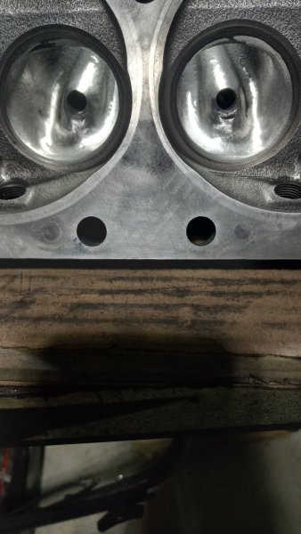

But I've got a little more adventurous with the area around the valve guides and the exit of short turn into the chamber. I'm about 85 % done the second head. I will have to go back and match the other head to this one though!
I will admit getting a lot more comfortable with the grinder ...can do a full intake in about an hour now.

I finished up porting the heads, I could have gone for hours more but was deffinantly getting into unknown territory and possibly just wasting hours more grinding! . I stopped where I felt comfortable.

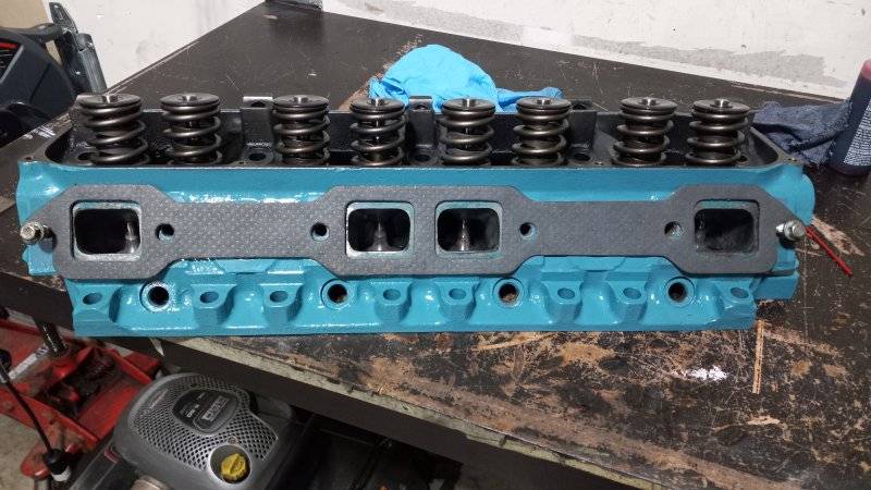

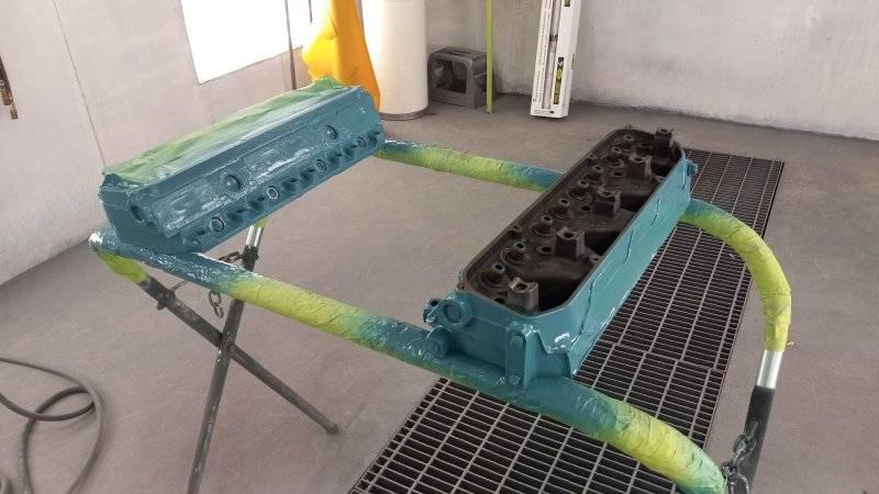

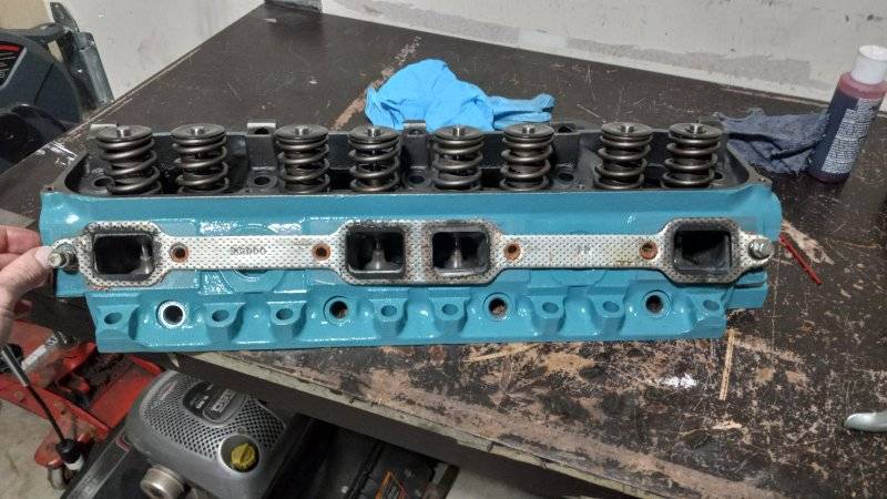

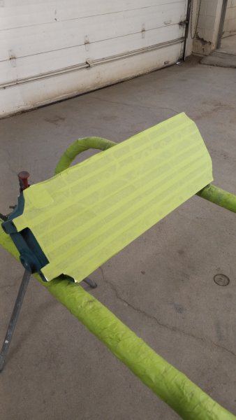

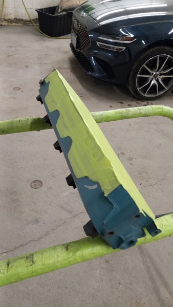

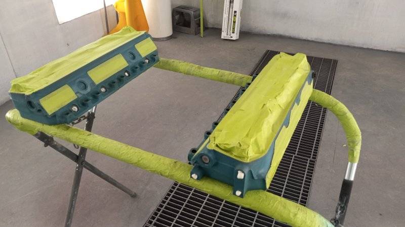

My day life is an automotive painter by trade . Brought the heads in the shop and put a coat of Utech polyurethane single stage on the heads to fresh them up! I did the intake and valley pan in this exact paint 2 years ago and still looks the same as the day I sprayed it.
I will give the heads a FINAL clean , make sure there us no grinding left. THen throw the valves and springs back in. Then start my reassembly .

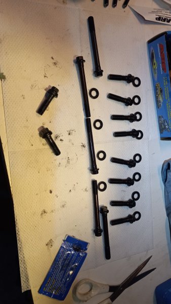

So far my order list is basic, ARP head bolt kit, felpro valley pan gaskets, header gaskets, felpro 8519 head gasket .
