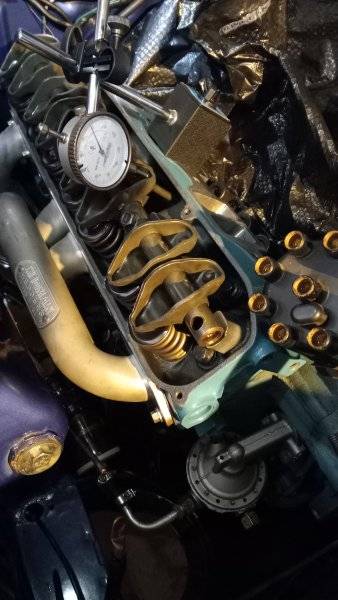

your not sacrificing any lift.Wow I not be sacrificing a fair amount of lift having the push rod that deep into the lifter
Opinions? Well you race it, so the less amount of room for pump up the better. Factory gave lots of room to cover sloppy machining tolerances and long term grandpa miles wear.
Be sure you're measuring properly
they have a melling stock type at roc auto and summit that am running 9.295 long. would help get your preload to .95They are factory push rods to the motor, I will check when I get home . I was assuming 9.315
something they maybe offer for more than for a 440 Mopar it is only . 15 thousand difference. some lifters only have 140 thousand travel like the anti pump up ones.What is lower pre load actually doing? . There must be something or manufacturer would not offer a recommendation?
You can shim the shafts.
With non-adjustable rockers there’s approximately zero chance the preload is the same across all 8 lifters. If you’re not going for max rpm performance you should be good getting them close to the middle of the range.
You probably had adjustable rockers though, right?When you could get high quality lifters with tru-arc retainers, racers/performance enthusiasts set the preload at or near zero. I set my lifter preload at 0.003. I could run 7000 rpm.
Unlikely you can do this with today’s aftermarket HFT lifters. And with that, just run what you have.
Yep.You probably had adjustable rockers though, right?
yes a solid lifter camshaft. going from .110 to .60 will gain you nothing.So if there is some performance potential being left on the table , that isn't going affect normal driving conditions or really have any negative affects on motor itself.
