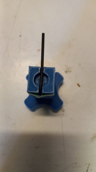

With the other cylinder head Torqued down. I went and installed all the pushrods and and rockers. I had a buddy over helping me, made getting all the pushrods lined up a lot easier! . Tightened down the shafts so they were snug , then gave the engine a few revolutions by hand make sure.everyrhing was seated proper and and moving freely. Then went and torque the shaft bolts to 25 ftlbs.

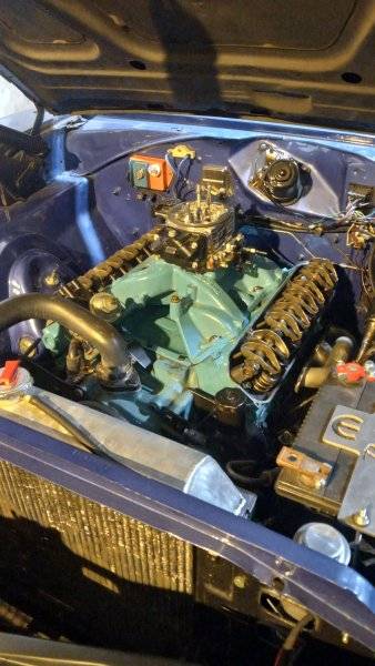

Lined up the intake next. If you remember when I pulled the engine down there were deffinantly signs of me pulling oil threw the intake. I originally had one of the paper gaskets installed, then metal valley pan and finally intake. No gasket between the intake and pan.
I tested fitted with JUST the pan, and no gaskets it seem to sit perfectly. I have a bore scope camera that hooks up to my phone. I ran it down 2 of the intake runner to see the alignment between the intake and the head. Everything looked perfect ( I had gasket matched the heads when the engine was first built ) . Looking back the gaskets I had installed previously was probably throwing the alignment off and causing thr leaking problems?
Used some black rtv gasket maker and applied across the front and back rails, and around all the ports on the block. Also applied some on the top side of the valley pan where the intake will bolt down to. Torqued all bolts to 30 ft lbs.
It's starting to look like an engine again !

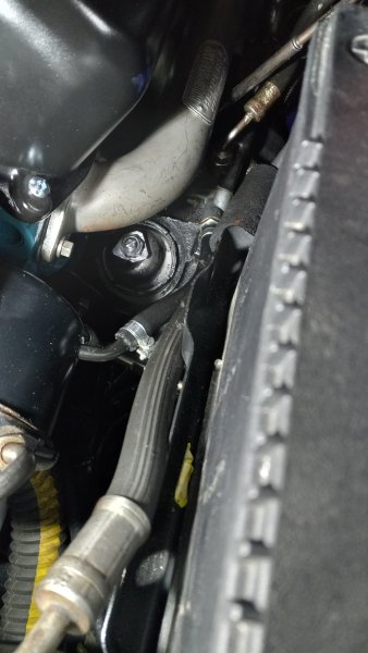

This is sort of side tracked from the engine tear down, but with the headers off I had great access to my power steering box that has been leaking . I took this chance to try and fix it again. The adjustment screw on top of box only has a slot in it, and was getting worn from me trying to loosen, tighten it over the year. I came up an idea and brought it to life with my 3d printer ! With an Allen key and my 3d printed tool, it work perfectly to break the lock nut loose. I cleaned up all the threads and removed the old thread sealer I had on there. My guess / hope was the threads were never competley clean of PS fluid when I tired to apply the sealant before. Cleaned then up with generous amounts of brake clean and acetone . Applied some new sealr and tighten everything back up. Fingers crossed that is fixed !
Aside from that I installed the headers , applied rtv to bolts since they all go into the water jackets. Got the valve covers back on, alternator , and ran the wires for the ecu, alt, horn ect.
