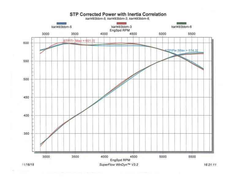

I had a 440 based 496 that used a 440 source kit. I used a 6bbl intake, hydraulic roller cam and eddy aluminum heads. It has been a few years since the build and I don't own the car any more, so I don't have the cam specs or recall which heads were used. It was a blast to drive. Below is the dyno sheet.
