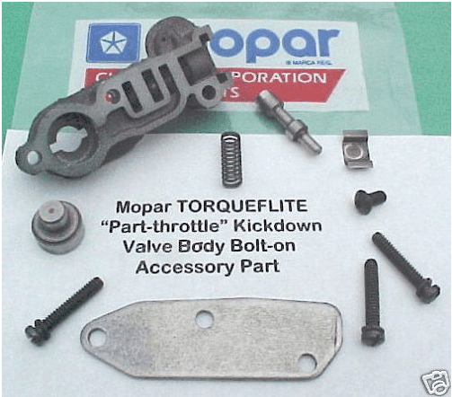

Is the PTK something to think about fitting into 70 and earlier cars?

I will look into it to convert it to PTK for sure.
Like you said, if you want to do a quick speed up action at lower speeds to overtake a car or so you don't have to go to WOT.
Just a good tap on the throttle to make it downshift to 2nd and off you go.
From what i read my '69 727 valve body can be modified for PTK, or does this require a post-'70 valve body?
Anyway i want to install a shift kit as well when i will do a rebuild on it this winter.
http://www.2040-parts.com/torquefli...ickdown-parts-kit-1967-valve-bodies-i1439756/
If you're not going to the nth degree looking for originality yes! A better, more driveable tranny. Luckily they can just swap in back to '66. In my case I can't get a cable shift or flange output onto PTK unit so I'm living with my original '64 tranny with another '64 as backup on the garage floor. Even if you don't swap, it's often helpful to change the governor spring and weight to nudge the shift points up some. Not downshifting per se but better than the thing jumping into 3rd by 15 mph and having to floor it or manually shift to get it back down.
