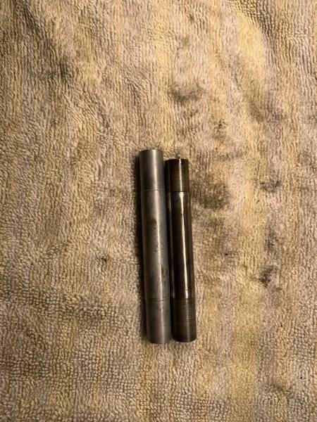

Thanks for all the help! It ended up being the pushrod. Only about an eighth of an inch short, but wouldn’t pump any fuel at all. Picture shows difference between old & new.
I just wen through this mess with my 72 GTX. Pushrod was 1/4 inch short. 50 years of wear.
Was gonna say, mine still drove with a push rod worse than that, only at WOT it stalled when the fuel bowls were sucked dry.
