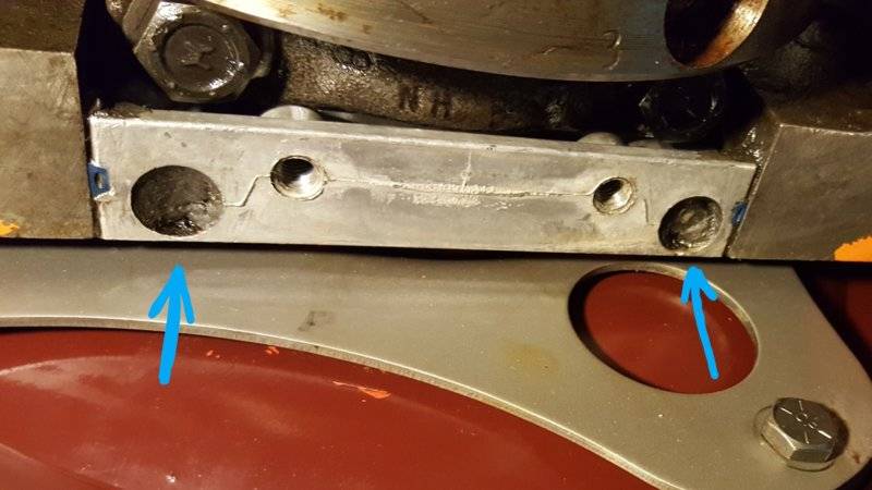

In some cases the pan gasket won't completely seal the two retainer bolt holes and oil will seep under the gasket and it will appear that you have a rear main seal leak when you dont. Fill these holes level with sealant before placing on the gasket.
Right next to those holes is a bigger problem. There is a gap and the only solid surface to seal to is the end of the blue side seal for the cap.
Fill that gap with a good sealer like “the right stuff” and have a small amount above the surface and put the pan on, don’t wait for it to set up.

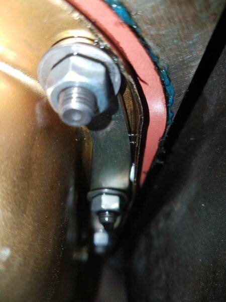

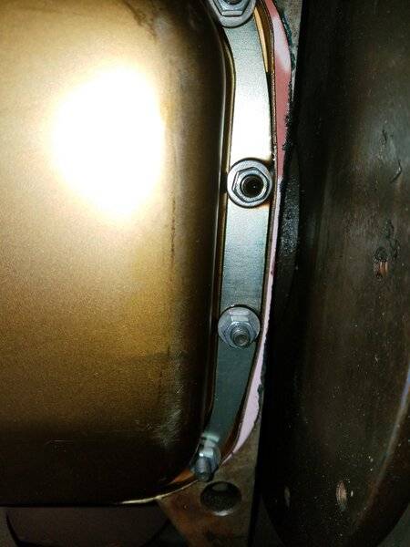

Here is my oil pan leak that I can't figure out. I've done all of what has been talked about above, still leaks.
