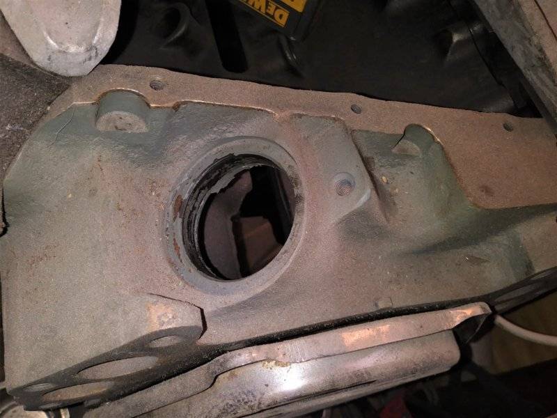

440 rear valley pan rail notches?
Low and behold....on the front of my 73 block...two corresponding indentations....lol. Bet they are to "locate" the block, upside down for machining on the crank valley area...

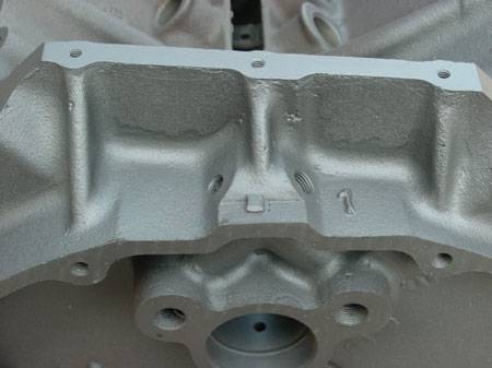

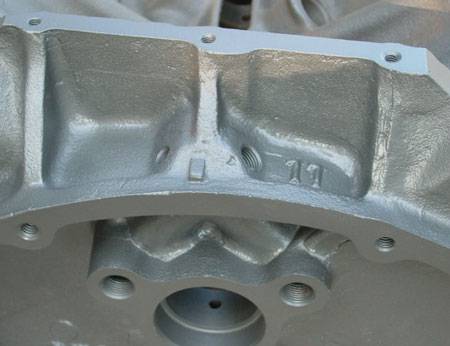

On 440 Sources web page they say that beginning in 1975 they changed the upper center bellhousing flange, not the bolt pattern, just the flange, from continuous curved to having the little rectangular bump up. Doesn't say why though..
Looks to me they did that to help facilitate machining of the flats for the holes and probably ease of access....getting in and out...? I know having a flat surface will help a drill to be able to not walk off center. Then again, I'm just a lost soul heading for the waterfall.
Now after looking at my 72 HP block it also has the same 4 notches on the pan rail too. So it’s about gotta be for some type of holding fixture of some sort
Locate the block onto those spots with round steel pins and apply pressure that block is going to stay put...gotta be for bottom end machining process...
Well thanks for all the replies I’m not so puzzled now:lol: now just gotta figure out why they are hit or miss on various year blocks
