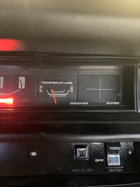

Not sure any of this helps but my 65 Sport Fury 383 is pretty accurate with the gauge reading. At 180 degrees, it shows about a quarter inch above that first mark on the gauge. I started it and warmed it up. The first mark on my gauge reads out to about 160 degrees engine temp and when I lift the wire to the gauge I read 15 ohms at the sender stud.
When the engine temp reached 180 degrees and I lift the wire to the gauge I read 12 ohms at the sender stud.
After shut down the engine temp creeps up to 200 degrees. I lifted the gauge wire and read 10 ohms at the sender stud.

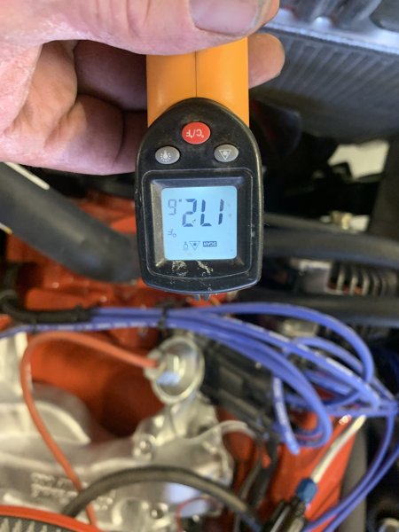

Heat gun on water pump housing 172 degrees reads 27.5 ohms with gauge wire unplugged

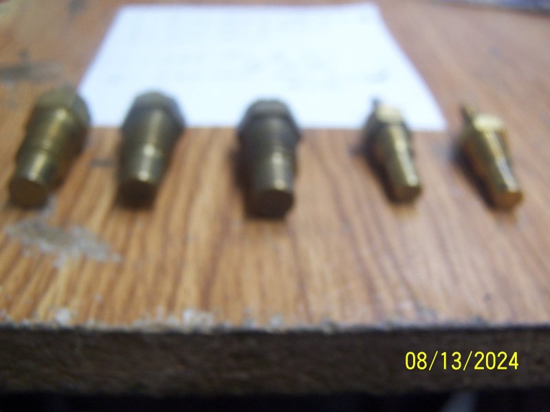

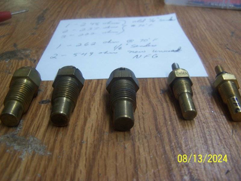

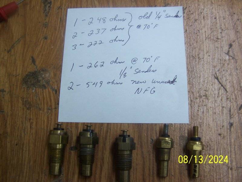

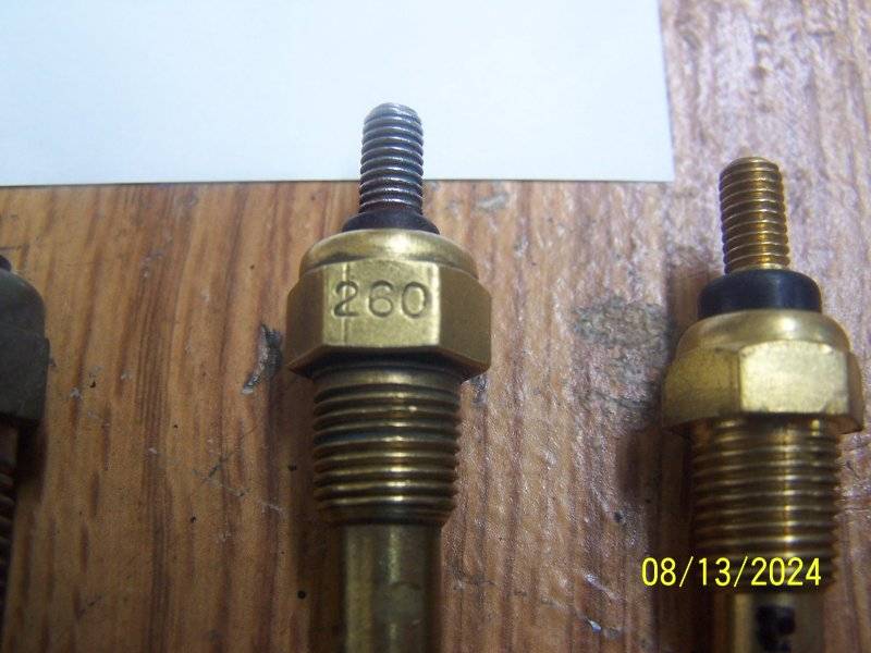

I have a couple of used ones. Just tested them at room temp. One reads 234 ohms and the other 241 at 75 degrees. There are some numbers on them. One has the number 250 and the other 260. I'm not sure if those numbers are significant or not.
I also have a New unused one that reads 500 ohms like yours does. I wrote NFG on it years ago so pretty sure the two used ones are good while the new one is in fact NFG.
I also have 4 of the older larger senders that all read around 230 ohms at room temp. Hope it helps.
If you have pay pal, I'd like to have you send me one of your extra temp sensors. Those two I bought from Tock Auto also read 500+ohms at room temp.
From testing 5 used temp sensors (3 older sensors with the 1/4 size and 2 with the 1/8" size) I would say they should all be around 250-260 ohms @ 70 degrees F.
From my testing, all of my used senders tested between 222 and 262. One new 1/8 sender read 549 ohms and I had marked it NFG years ago so that one appears to be junk like some of the new senders. The one 1/8 sender I have has the numbers 260 stamped in and reads 262 ohms so I gotta believe that is what it should be. Good luck finding one that works for you.
