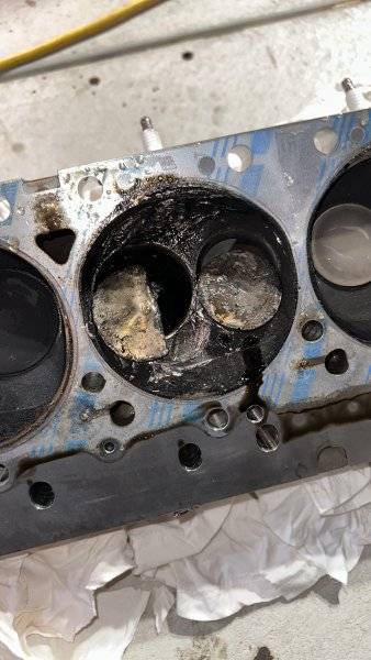

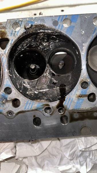

440 valve failure
If it were me, I’d try to replace just that valve/piston (& check the rod). You can pull 1 head and get at what you need without even pulling the engine
Yeah pulling one head and reassessing it. I need to make sure there isn’t any chunks of steel in the engine though which is concerning

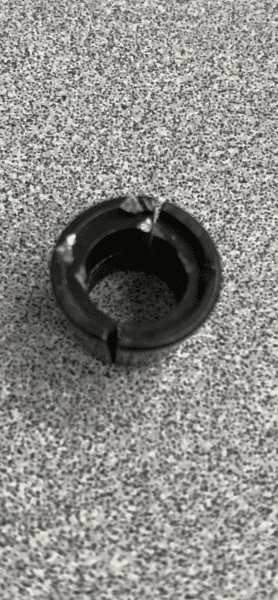

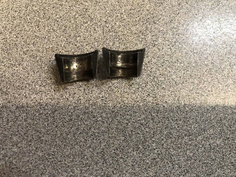

Here’s an example of keepers that had the tangs sheered off…….
There no indications of any problems on the other 15 valves/retainers/keepers.
The valve spring on the position that failed was down 30-40lbs from how it was installed.
The other 15 were still fine.
Before these keepers finally let go, they had moved up the stem to the top of valve, and there are witness marks on the top of them from contact with the rocker arm roller wheel.
So, the failure is a result of lack of control of the valve…….. because the spring lost a bunch of pressure, and that hammering finally won the battle over the tangs of the keepers.
The unanswered question remained……. Why did that one spring give up?

Correct me I am wrong, but.......the original Chrys keepers that had the 2-3 round ribs. Didn't the keepers butt together in the retainer, leaving the valve 'loose' on the keepers?
haven't used those locks in years but pretty sure the exhaust locks let the valve rotate but intake locks didn't.

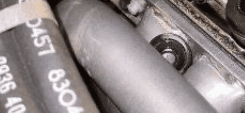

I wouldn’t mind a good look at the topside of that retainer……..
Agreed. It all depends on how quick you shut it off. I’ve done this myself successfully
It depends purely on luck.... If you think your quick enough to shut down an engine before damage occurs consider this... At 3000 RPM the piston will travel up and down it's bore 50 times per second... Pure luck... Period...

I’d be pretty surprised if the root cause of the failure was that the valve just broke, “for no reason”.
I believe with disassembly and careful examination of the valves/springs/locks from the valves that didn’t break, some light would be shed on the actual cause of the broken valves.
But…….maybe not.
Wrong parts, poor assembly, excess abuse sets up some crazy harmonics in the valve train. I doubt anything would tolerate that for any length of time.
