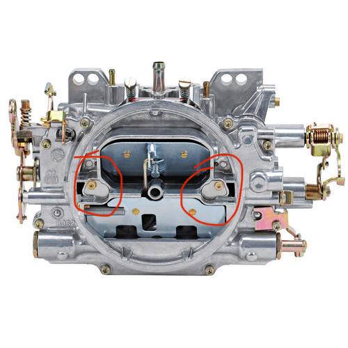

Or if you can afford it and hit the easy button. The Edelbrock avs2 800cfm is a good choice too. Buy the tuning kit that comes with it, it’ll have a chart to help based on your afr numbers, most of the time it’s just metering rod changes, and you don’t even have to take the entire carb apart to do that. Just loosen these screws, pull the cover to the side, and make your change.
