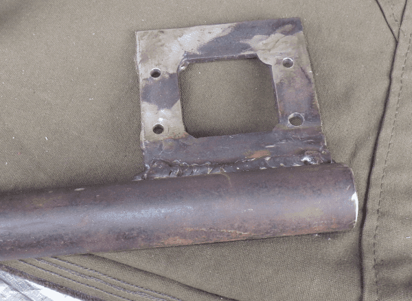

You can pick up a used pipe wrench (big) from a pawn shop for pretty cheap and then grind the teeth off and then it won't mar the yoke. Using a piece of flat stock and with a plasma cutter, a tool can be made that slips over the yoke to prevent it from turning. Weld on a couple of long handles to it and it's done but a decent impact will usually get the nut off without holding it. I've been doing that for years on the bench and while in the car like mentioned in my earlier post. For the ones that need to use a torque wrench, making a tool to hold the yoke in place is about the only way. I just use the impact and then check torque preload but you got to take into account if a seal it installed since it will affect torque readings some....
I made this from a 3' length of heavy wall tube that I've used for "persuading" over the years and some 1" flat stock that was laying around. (7290 specific as is)
Bolt it to the yoke, remove the pinion nut, pull the yoke with a 2 jaw puller, unbolt from yoke ............
