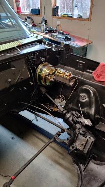

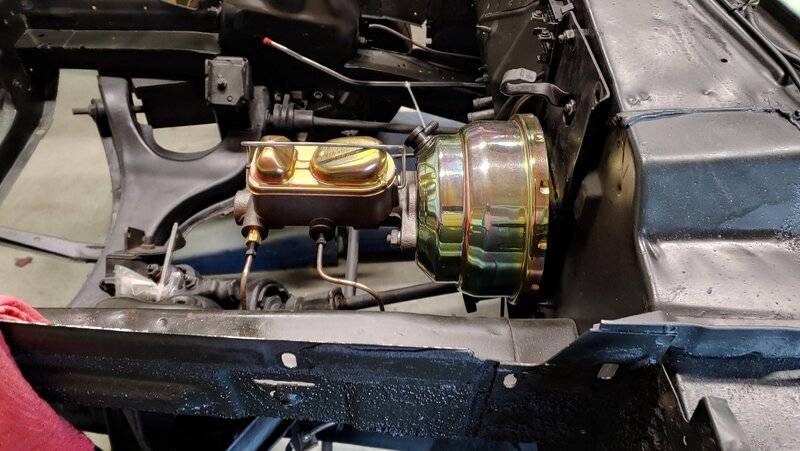

Are you certain your master is disc/disc and not a drum/drum master with residual pressure valves inside master? Post a picture of your new master, I can tell
