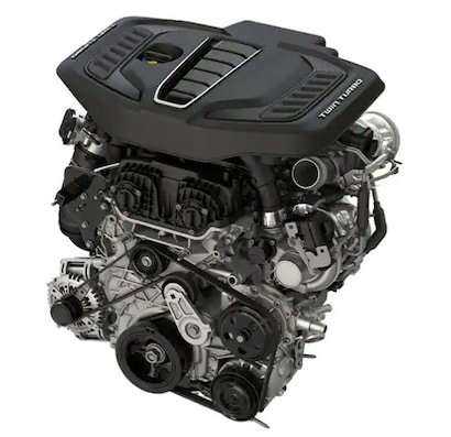

Sounds like you would be interested in an inline six for fewer plugs and relief from access around the brake booster. Here you go. :poke:
