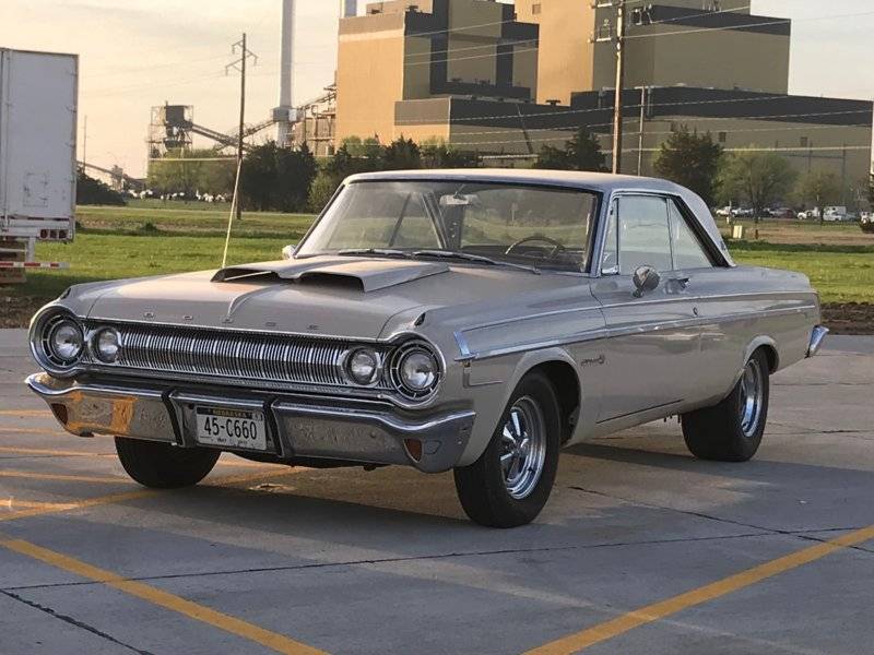

Previously I had submitted a post concerning the addition of a Holley Sniper FI unit to my 1964 Dodge Polara 500. The question was asked at to what kind of fuel mileage I was getting with the car. So I decided to start keeping track of it. I knew the speedometer was off substantially so I did a couple of tests to determine the extent of error. The first was a 10 mile test using the odometer of the car and mile markers along the road the other involved a direct comparison between the speedometer and GPS speed. The calculations showed the speedometer was off by 1.23. Here are some of the specifics for the car:
  1. 3.54 gears, P295/55 -15 ET Street SS tires
  2. 500 cubic inch stroker (400 block)
  3. ProComp CNC ported Aluminum heads 325 CC intake runners
  4. Heads flow 330 cfm intake, 250 cfm exhaust @ 28"
  5. Harlan Sharpe, roller tip, 1.5 ratio rockers
  6. 230/236 @ .050", .550" lift Comp Roller Cam
  7. Torker Intake (Ports opened up to match heads)
  8. TTI Headers, 1 3/4" Primary, 3" collectors
  9. 1800 RPM stall, the motor is a torque monster.
  10. 9-1 Compression
  11. MSD 6AL box and distributor
  12. TTI 2 1/2" X-Pipe Exhaust
The tests were done basically driving to work which is a 25 mile trip through rural Nebraska so not much stop and go driving. I tried to maintain 60-65 mph. Here are the results:
1) 4/20/18 9.1 mpg (3 or 4 full throttle blasts)
2) 5/8/18 10.1 mpg (the best grandma driving I could do)
