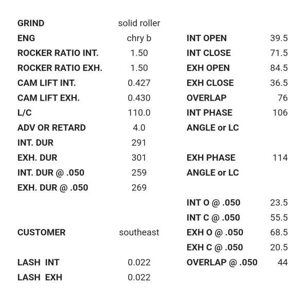

Hey, I left my 572 "70% street/30% strip" cam specs up to my Mopar centric engine builder to decide. Solid roller, and Michael at B3 Racing Engines is providing the T&D 1.6 ratio rocker arms and valvetrain geometry correction kit. I really love the sound of my current cam (292°/.509) not sure of the LSA on the Purple Stripe in my 440, but I LOVE the sound at idle. I'm thinking this one should sound pretty good too??:
w/1.6:1 rockers
0.427" cam/lift = 0.683" gross valve lift intake (not including deduction of the lash)
w/1.6:1
0.430 cam/lift + 0.688 gvl exhaust
291* adv. intake
& 301* adv. exhaust duration
should be/have a lil' bit of the ol';
bucket tee' bucket tee' bucket tee' bucket tee' bucket tee'
choppy-sounding camshaft at about 1000-ish (min.) rpm idle
roller cams 'sometimes'
(usually in my vast experience)
tame down the choppy 'idle tone' too
(sounds like it's a bit faster between 'bucket tees' if that makes sense)
more-tame sounds, at the same spec
(but way better cam)
than an old design like the Racer Brown 292*
or MP/DC Purple Shaft .509"/292*
Hydraulic Purple shaft FT/solid or Hyd. cam would...
I had a few of them back in the day, street cars...
Loved the sound
, not the best cam though...
should sound nice
