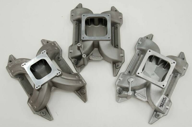

I stand corrected! I think I was thinking of the LA intakes that they didn't have originally.
You know, it's just great that we have more options available, it seems every day that they've been dwindling down. While the RB has some great manifold options, the low-deck has just a few for this displacement and power level.
