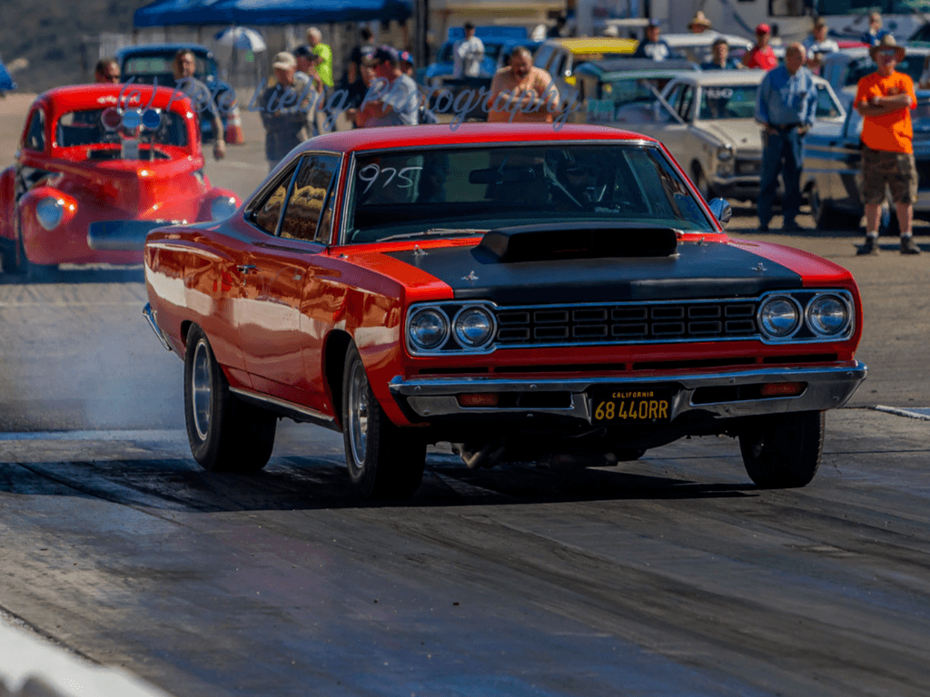

Good stuff John, it was good to meet you in person. Pretty cool we got to run each other in my first pass. I was having an off day for sure, my car wasn't digging the heat. I was unprepared for the day and it showed, won't let that happen again. I wish I had done a better burnout for this pic but I was running my street tires and wasn't eager to trash them.
