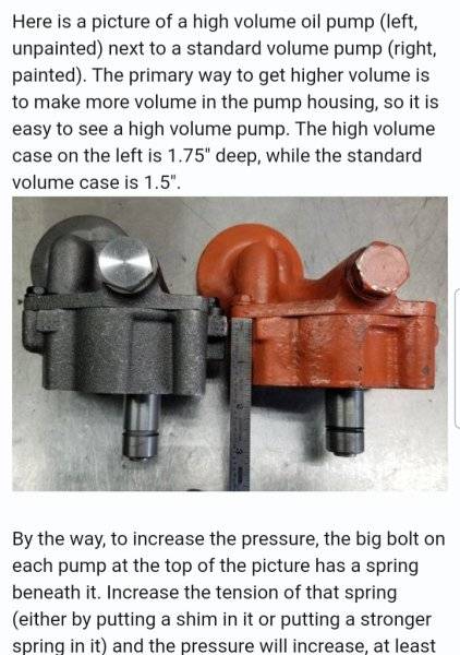

You can't use hardware store parts on a Mopar!! LOLSometimes I don't remember things. Looked under there and then remembered I had to add some washers to get the long bolt to work. Other bolts were fine. I can't get a good measurement on the pump in the car but the one I took off is HV based on the case measurements in that photo. I learned something new in this process!
And the one on the old engine is also HV
And I don't have any washers small enough so I have to go to the hardware store
Is there an MP part # for the washer shim? =)You can't use hardware store parts on a Mopar!! LOL
At 10-12psi hot idle, no thank youDisconnect the gauge and drive it. ...
