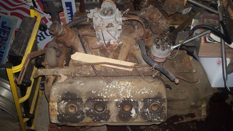

I have an opportunity to checkout a 52, 54 desoto with a firedome hemi. It's been sitting in a private salvage yard and I don't know what to expect. With this limited information anyone have a estimated value?

It would have to run and have all trim. No parts available for the Desoto Hemi's. 52-54 will have the smaller engines. 276 c.i. .160-170 HP.
Early hemis, not sure which ones, have part of the bell cast into the engine block.
Found this out last weekend.
Also found out there's an early 345 DeSoto hemi, one year only.
Most parts on Gen 1 Hemi's won't interchange between brands either
DeSoto, Dodge & Plymouth Hemis, all different 'cid's' too
have no idea on value
not really highly saught after/popular body styles especially,
but could be worth something, 'the engine/trans' (?)
Dragzine.com just had a write-up on
Hemi History --10 facts of early Gen-1 Hemi engines"
sorry I didn't save the link

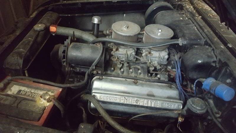

i have a few desoto hemis they are hard to get parts for and speed parts are hens teeth , you end up making alot of your own stuff . the nice thing is the litte dodge hemi intakes are close to bolting up , but still need port and mounting holes mods to mount correctly . yes that would be a 276 the smallest ci motor desoto made , 55 was a 291 ci , high deck began in 56 330 ci , and so on . desoto had factory high performance versions , but there far from being common place .
Hot Heads has parts.

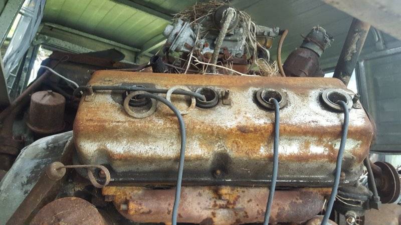

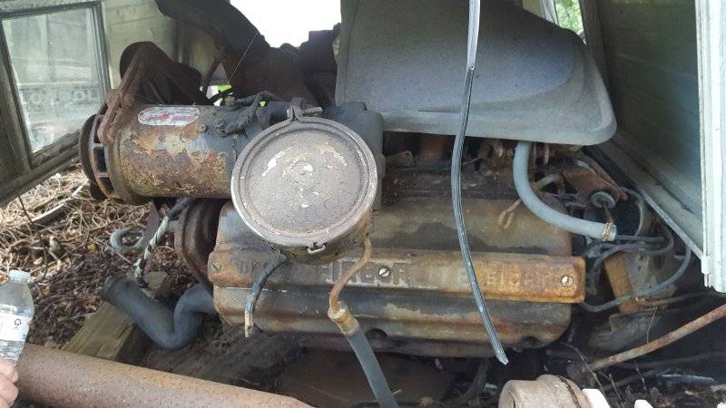

More hemis, two are 4 barrel, two are 2 barrel.
I know I can bolt hemi heads on my 58 325 Dodge, has to be Dodge heads.
Iirc, valve covers don't even interchange.
