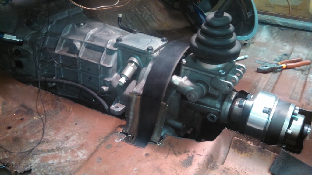

here is my tr6060 with a top loader...
Im just going to go with the same shifter just had so many people saying nobody made that conversion till I got your
pics. Looks awesome I will try to replicate what you have
done really appreciate help.

We chose to keep the shifter with the offset and positive stops it is going to work fine.Although we had to make some modifications to the plate we just had scott mock machine a new plate looks like factory and fits perfect. Pics will follow.
Really appreciate the info had no idea they existed looks similar to what we installed except the one I purchased has the offset which should set the shifter back farther. If its too far back all I have to do is cut it shorten it reweld it. Thanks for info that's what these boards are about good discussion on many topics.

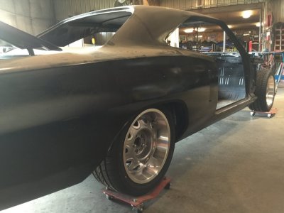

Heres our car still a long way away but chipping away one day at a time!
