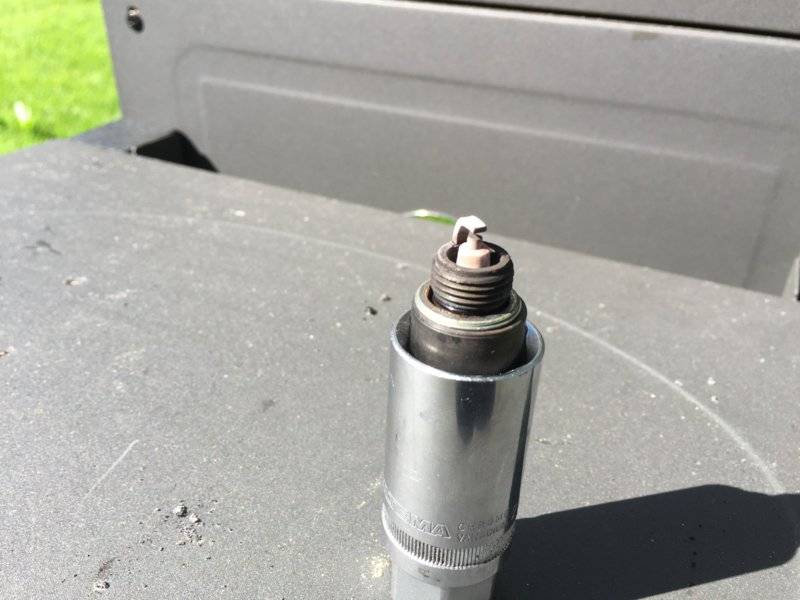

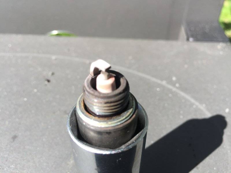

Ok a day off testing got me nowhere the twitch is still there have tried everything but nothing helps vill start testing the elektroniks tomorrow !The only thing i kan tell you is that more than 5 degrees off ignition makes it worse the engine reacts to every change i do air ,ignition even changed thermostat so the engine would run warmer so the systems work but the darn twitch dont go away!
Sorry you are having all this trouble, these things are hard to diagnose when you aren't there to experience what it's doing. Let me ask a few more questions:
How long has it been doing this? Any change just before it started?
Have you pulled a plug to see if you are actually running lean or rich?
Have you checked your float levels in the carbs?
Have you checked your fuel pressure? (in particular around whatever rpm you are getting the stumble) What kind of fuel pump are you running?
Let's eliminate these and if still no good then move on, I have to tell you though that something doesn't sound right with the timing. I have never ever had a big or small block Mopar that ran best at an initial of 5btc. What's the timing light say all in? (3500+ rpm) Should be somewhere around 36btc but every engine is a little different depending on too many things to list here
What you say boys bone dry no deposits normal driving no 1 cylinder !
