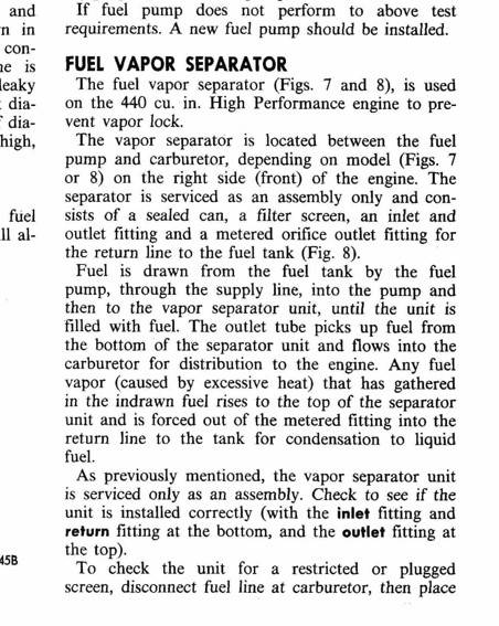

The ¼” fuel/vapor return line running back to the fuel tank from the fuel pump vapor separator? Liquid fuel found in this line is to be expected. An obstruction that couldn’t be cleared by fuel pump pressure would render the fuel pump vapor separator ineffective however. There is a constant flow of fuel and/or fuel vapor returning to the tank in that line while in operation as designed.
...is that better now?
If there is no heat induced fuel boiling taking place in the incoming fuel line, there will be no vapor to separate, what is returned to the fuel tank is then liquid fuel. It’s a return line, not vapor only return line.
Returns vapor and fuel to the tank at a constraint rate as determined by the orifice in the fuel separator while in operation. It is intended for there to be liquid fuel in this line, there is no reason to blow this fuel out as described.
It's always been described in the factor docs as a "return line", not a vapor only return line.

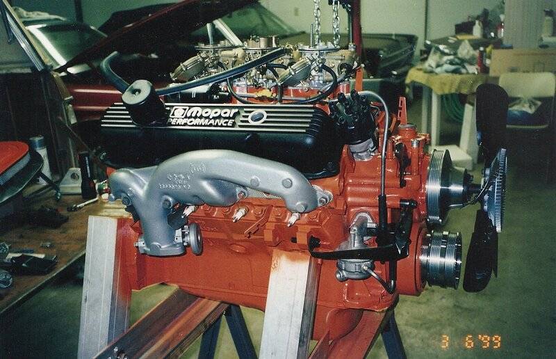

That vent on the center carb should be hooked to the breather cap as shown in this pic. I've seen a lot of them not hooked to anything at all.
it does not go to the breather it goes to the air cleaner you don't want to put gas in your engine you don't want to hook it up to anything that has positive or negative pressure I know this because I called Holly
it doesn't go there you'll be sending fuel into your motor you never hook it up to any vacuum source whether it be positive or negative the that that tube goes to the air cleaner there's a nipple on it for how I know this I spoke to Holly about it
Not correct, perhaps you should have a looked at the factory service manuals from ’70-71, relating to the Evaporation Control System, it's function and the correct information on the fuel bowl vent valve hose routing.
Called Holley? Did you ask them why the current re-issues of the ’71 center carbs (list 4670) are shipped with this correct sized 3/8" hose, at the correct length, to connect the bowl vent valve nipple to the correct ’70-71 3-nipple breather, if that's not where it goes?
Your comment doesn't make any sense. If you have gas in that bowl vent, you have bigger problems. It is vapors not fuel. Plus, if you did have fuel there, why would you want it going into your air cleaner? Either Holley gave you bad info or you miss understood it.
