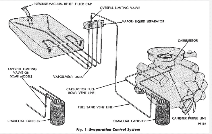

73 Charger - Vapor Separator?
There's a brass shuttle valve in there that keeps fuel from flowing the wrong way.
It can stick.
If it doesn't rattle, it's stuck.
As I was getting the mower out of the barn (uughh, it's that time of year again), I gave the separator a shake... it rattles!
(Is that the only difference between the '72 and '73?)

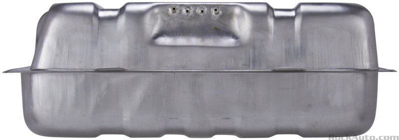

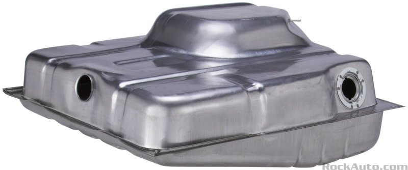

Not Sure, my car is kind of an abortion, and I don't have all of the specks and details of who did what. I also had a leaky fuel sender from the tank; so, while I had it up on blocks, I decided I wanted a stainless-steel sender. I got one from Summit Racing. Unfortunately, they only had one in 3/8" instead of 5/16". Then, I had trouble getting a hose adapter. I didn't want to use a coupling & threaded adapter, so I ended up ordering a double barbed, one-piece brass 3/8" x 5/16" from a marine supply as even searching on multiple Autopart's &/or racing suppliers yielded nothing. The next issue was that the stainless-steel lock ring was too thin to seal at the tank. I ended up using the original steel lock ring and all was well. Nuthin like fun N"Games!

On my 72 charger I couldn't tell if mine was any good or not and didn't have much luck at the time finding one so I ended up taking fuel hose and looping from one nipple back to the other for all 4 and bought a vented gas cap. I don't believe it has caused me any issues. Sometimes I wonder if I should run them out somewhere higher for vents as the only vent for the tank is through the cap then.
I had the same issue on the aftermarket tank and ring on my 68. The ring was too thin, and I had to buy a factory ring off one of the guys here on the forum. It fit like a glove!
Same here
BUT also the welded lock ring receptacle at my replacement tank was also too thin and gets bent easily. So It had to be gently locked.

I agree about the lock ring issue. Save your OEM ring.

I think the sliding sleeve is part of a vapor recovery system or to prevent vapor from venting to atmosphere, not sure!
