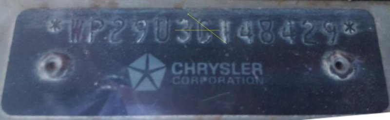

73 charger with a coronet Ser#
No its a C for Jefferson Michigan

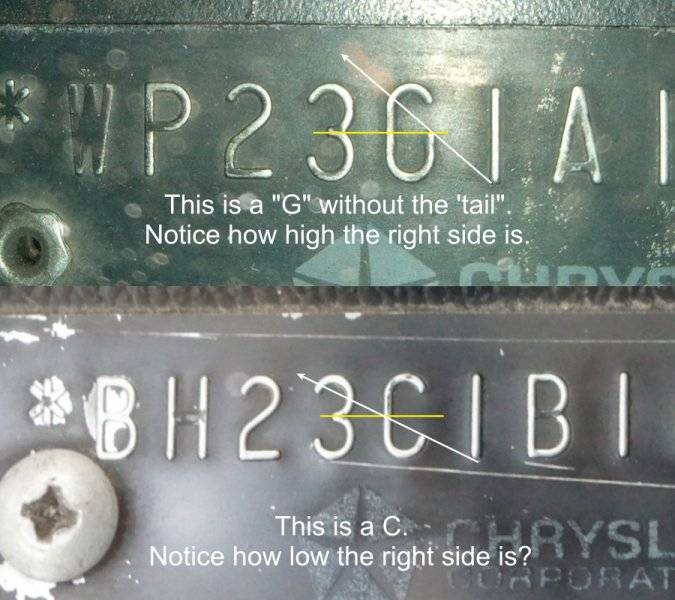

No. It's G for St. Louis. C plant built Chryslers and Imperials. 1973 Chargers were built at Lynch Road (A) and St. Louis (G). Sometimes the tail on the G is stamped so lightly it doesn't appear.
Look at the difference between a G and a C:
Thank you very much. I can see this being confusing as its really hard to tell it is a G. But I can see it now.
