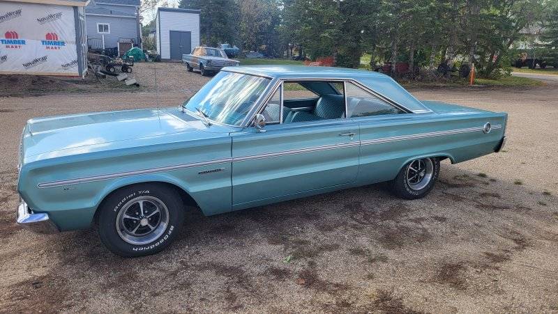

Whos running 15x6" rims all around? What backspacing are you running and what size tires? I can't seem to get a good answer on rim sizes...I don't want 8" rims and I can't find a good 15x7 with a 4.25 backspace. I don't want to have to worry about rubbing in the rear. I'd like a taller tire aswell. I'm thinking 225 70 15 fronts and 235 70 15 on rears with a 6" rims. What you guys think?
Heres my new ride, 66 belvedere 318 auto

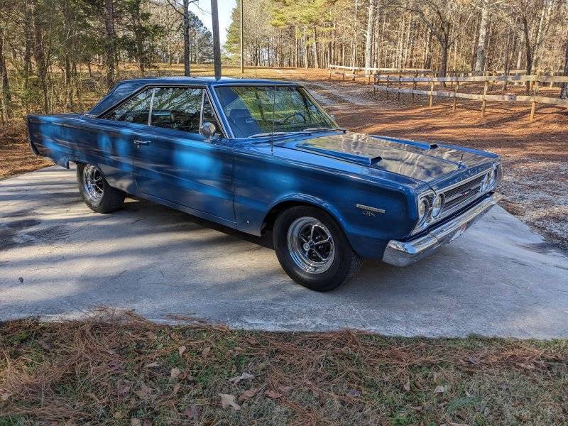

I have 15x6 wheels with 235/70-15 tires all around on my 1967 GTX. The wheels are Wheel Vintiques 54-561204, 15x6 with 4" back spacing. The tires are General Altimax RT. They clear with no rubbing. This car has rolled fender lips though from previous wheels which were 15x7 with 275/60-15 in the rear, but it looks like the current wheels and tires would not rub without the rolling. The front wheel wells have minor rolling as well. Without that, it might be tight on full turns.

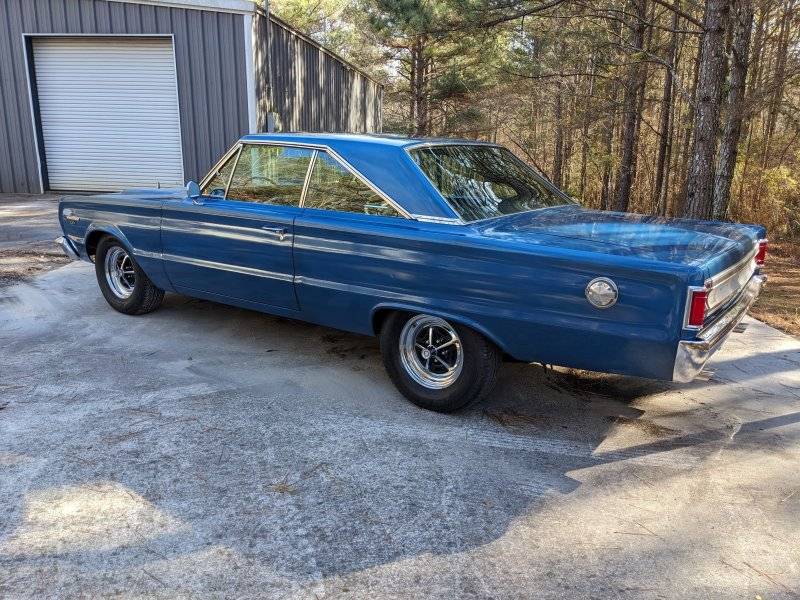

245/70/15 on 15x7” rims with 3.75” backspacing. It was the perfect combo, at least I thought so.
Beautiful car!! Why don't you think they are a proper fit now?
I still do, but after over 25 years of ownership, it left the nest for a new owner about 5 years ago. Replaced in trade for my 70 Roadrunner.

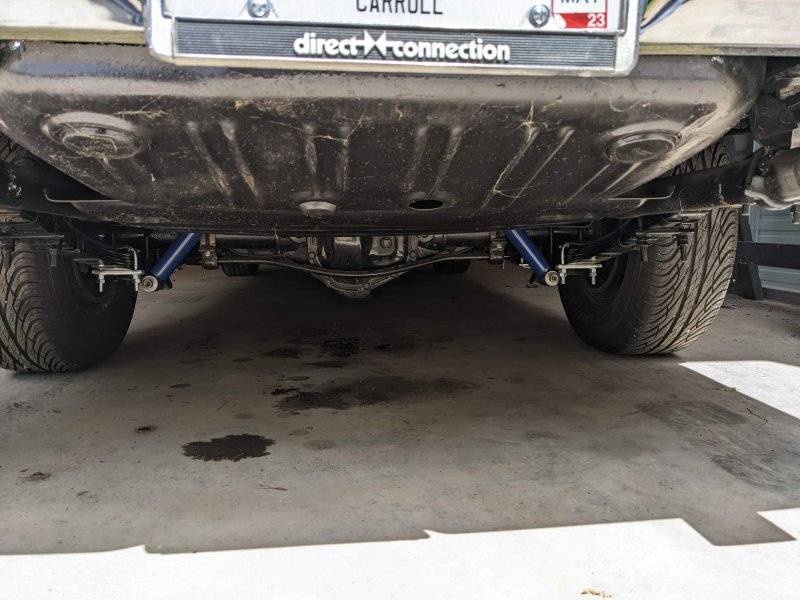

No idea on backspacing but just for visual comparisons ... this is what 255/60 R15 rear and 205/65 R15 front look like ... previous owners choice - I will be changing.
