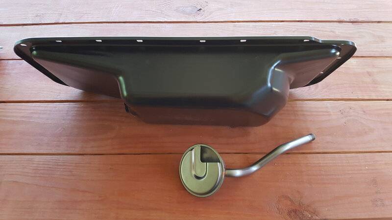

For very annoying reasons I can't fully explain, the stock 361 pan bottoms out on the stock 361 pickup when installed in this 440…
Interestingly I had about the same experience. The shape of that pickup is awful. I did get it to work but there wasn’t a chance in hell the windage tray was going to fit, at least without a lot of butchery.
Stock pickup is supposed to touch the pan. The design places the screen at the correct height. Aftermarket with the screen at the lowest point obviously can't touch.

Thank you for the reminder on that, it’s been awhile since I pulled the stock one apart and even longer since my last build. The 440 block needed a little more threads cleared out the receiving hole for the pickup to make another turn or two, and it ended up going together the way it was intended.
So update on all that for me, stock pan and pickup off the 65 361 is now on the 440 and sitting correctly in the car. 5 quart system is a little light in my opinion on a mild engine so big but it’s how they came stock in many instance so I’ll just treat it nice til a potential future part swap and use the biggest filter I can find.

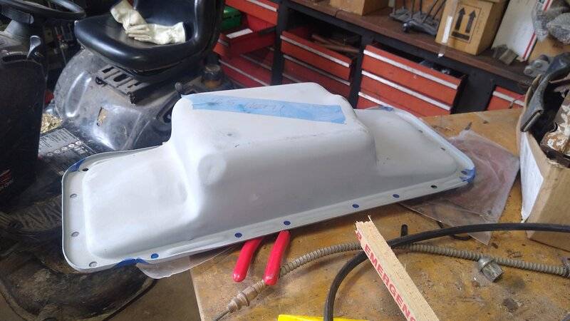

I wanted to share this info in case it saves anyone some time and money, I searched for a while when putting together a 440 for a 65 SAT and never got a definitive answer.
The 440 source 6 qt hemi pan DOES NOT FIT. It doesn't even come close.
