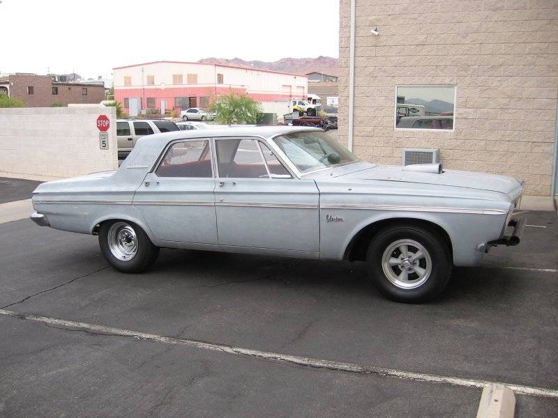

My old hoopte. TT 15x5 215/75/15. Inexpensive Ironman tires made by Cooper.
I have bee running Ironman on all my vehicles for about 10 years now and get good service.

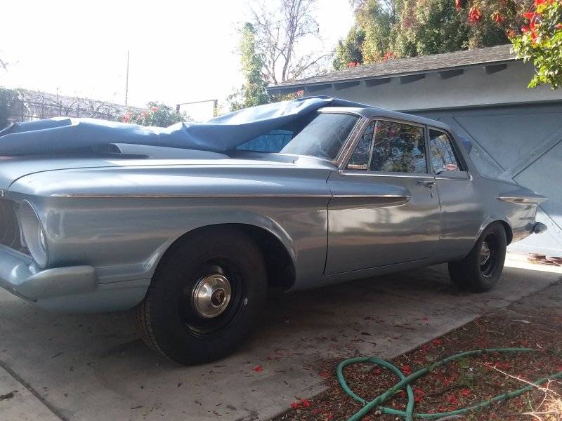

You can't go by what I get away with, cause a previous owner trimmed about two inches of front valence away, for tire clearance.

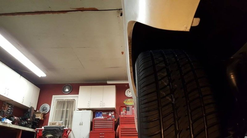

Yeah, i don't wanna cut up any metal if i don't have to.. was thinking 225/70/15ish... BTW 33, you are running the 30" et streets also aren't you? (might be wrong person, my brain is ****) and you look bout the same height as mine.. do the outer wheel wells (the part inside the outer skin that follows the body curve from the wheel well lip) ever rub? or how close are you? I THINK i am gonna get away with mine.. with maybe a rub if i go over something that makes the whole car squat bad..

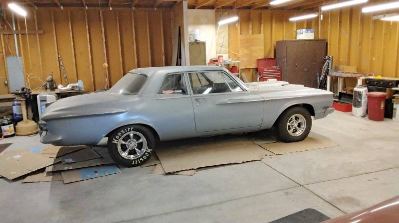

I've got 10.5-28x15s on the centerlines, (4 7/8 bs, need .300 spacers) and 10-28x16 on the tt2's with 4.3/4 bs .Both full-on slicks. The 10s fit well, the 10.5s are pretty tight. The car is as high as it is (ss springs) to keep the fender off the outside sidewall. I don't have any rubbing problem on the inner fenderwell. The t/as are on ramcharger 15x8s, with 255x70. I wanted 275, but the ramcharger rims didn't have enough backspace.
My next pair of rear tires, if live long enough to wear out the hoosiers will be 9x29 or 30, i think. I do have some new et street bias for my barracuda, and some giant Hoosier qtp for my Opel.
Your 225x70s would be a good choice, imo . Would work on 6s or 7s, not too tall, not to short.
And that is some badass-sittin 65!

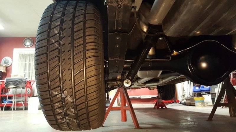

Ahh.. yeah.. i could only fit 4.5" BS and went 30" so it's a bit tight.. maybe 1.5-2" before i would get rub... but nothing sharp would hit.. still not ideal.

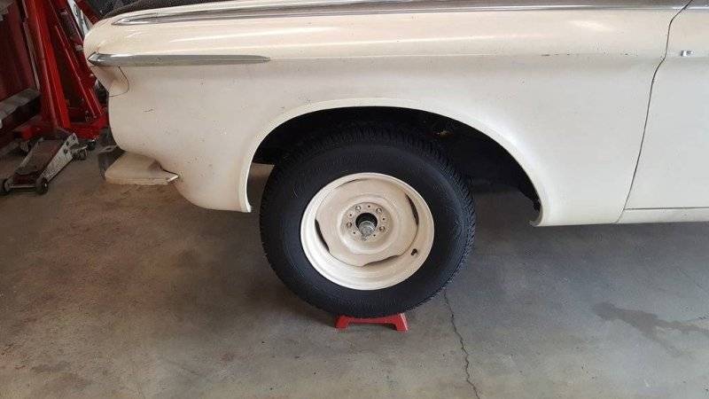

Clearance on the Dodge with the 225/70/15 4.25 BS
The rears are 275/60/15 on 8"w 4 1/2" BS. Had to use a 1/4" spacer for inner spring clearance. Should have used a 4.25 BS. No rubbing.

thanks, and those fronts are way more forward than i thought they would be..might wait til my fenders are on to decide.. that's a 62? your rears are in about the same spot as mine and that inner i think is gonna hit (inner on the outisde if that makes sense) is gonna rub.. my tires are fatasses though
Yes on being a '62. The rear 8" rims had plenty of room until I had the tires mounted. They really bulge. There's a chart online somewhere that shows how wide a tires sidewall is when mounted on a certain width rim.

yeah.. i don't get how you measure front BS due to turning and all that.. my section width is 12.5" on my tires.. tread 10.5, using 4.5BS with the springs moved in like 3/8"
Well I'm using 15" x 7x 4.25 BS and the upper ball joint is about 3/16" from the rim. So I wouldn't go any less BS than that. Everything else clears fine with the 225/70s.
thanks, good info :) And i kinda wish i had gone 9" wide in the back but i wanted the 30" diameter... and didn't want truck tires. no biggy though.. looks good :)
