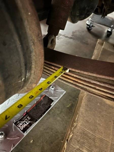

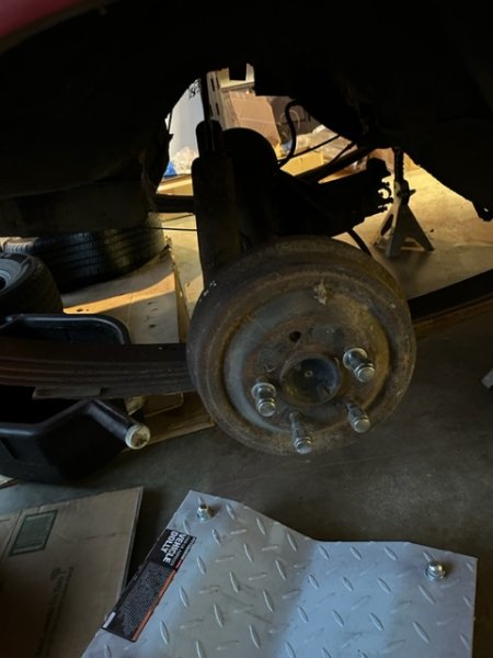

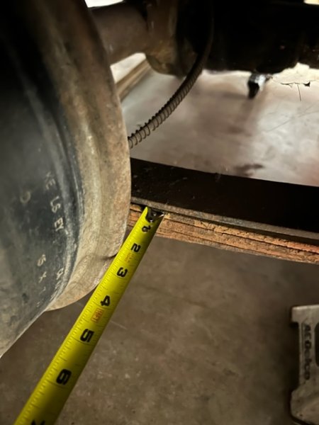

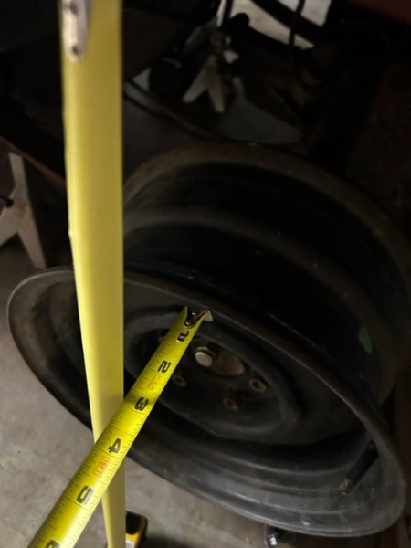

I did my measurements from the face of the axle where the wheel would mount
If I did it correctly let me know
Horizontal wheel well opening: 31"
Face to drum to inner lip of fender (driver/passenger): 7"/7"
Face of drum to leaf spring: 6.5"/6.5'
Opening from outer quarter panel to inner wheel well: 14.5"/14.5"

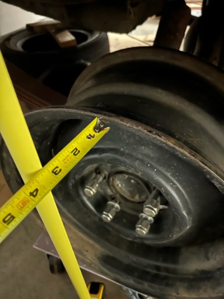

I took a few more photos with the solid steel wheels mounted.
From the outer most edge of the wheel to the lip of the quarter panel (driver/passenger): 3"/3"
From the inner most edge of the wheel to the leaf spring (driver/passenger): 2.5"/2.5"

From your measurements in #22, that wheel is virtually perfect, you can probably put the widest tire that is recommended for a 7" wheel on your car.

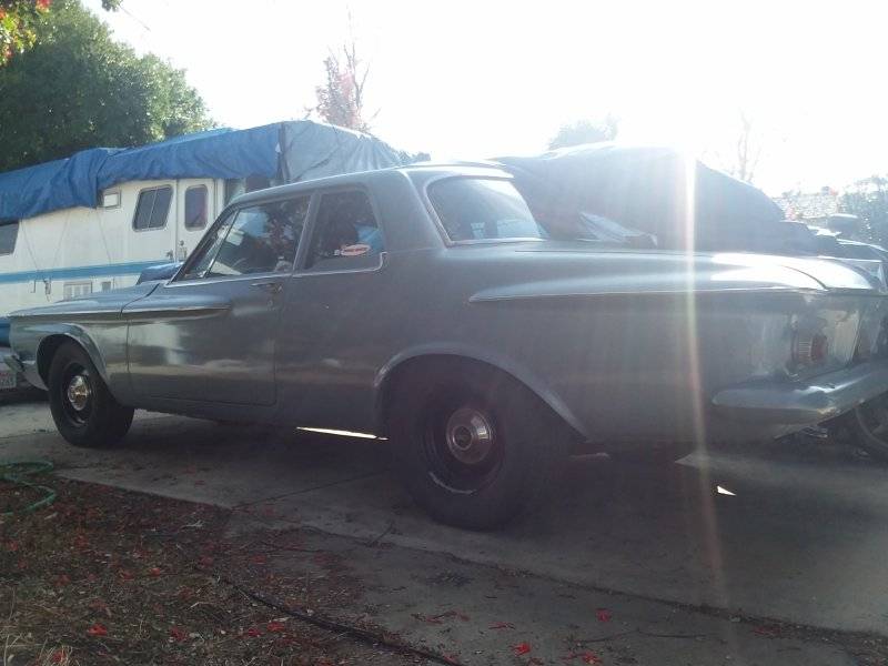

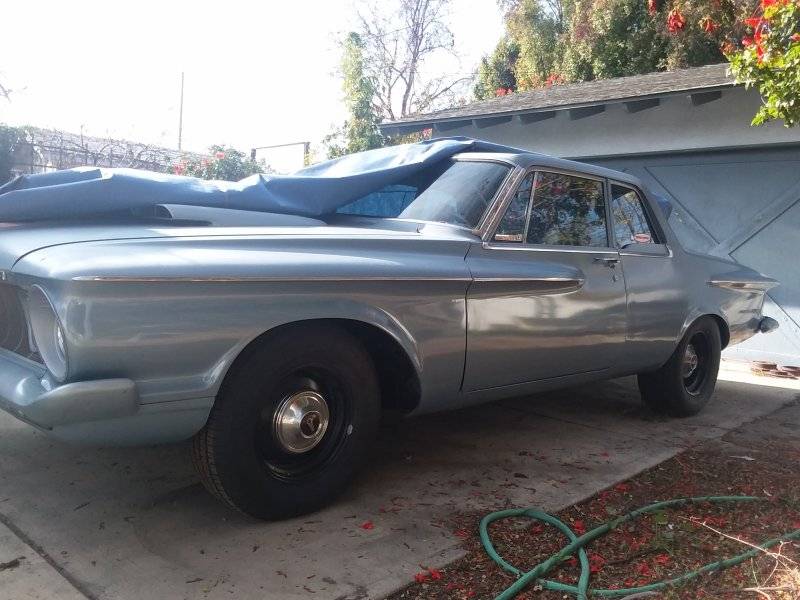

Your 62 looks rad!

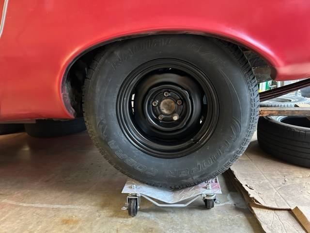

I made progress!
I had my wheels media blasted, powder coated, balanced the wheels, and had them mounted to Cooper Cobra tires and here is the result.
The tires fit on all 4 corners perfectly!
I think it turned out great and I love the look.
Thank you everybody who commented and made good suggestions.

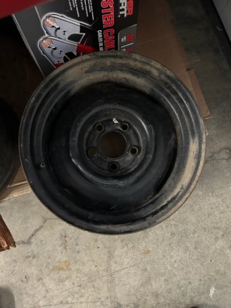

I'm at an important part of the build process. The wheels and tires.

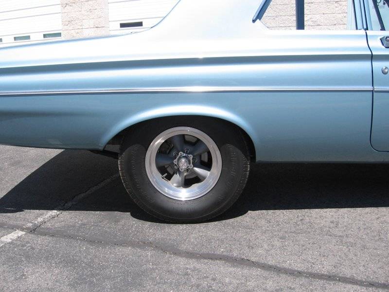

I wanted to go for the 64 Ramcharger style with 5 spoke wheels in the front and solid steelies in the back.
I have a 14x6 5 spoke for the front and 15x7 solid steelies for the rear.
For the tires, I'm looking for confirmation that this is an adequate set up.

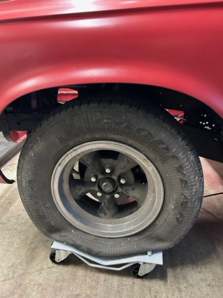

And here are 2 pics of my wheels for reference.
Here is the setup on my '64
