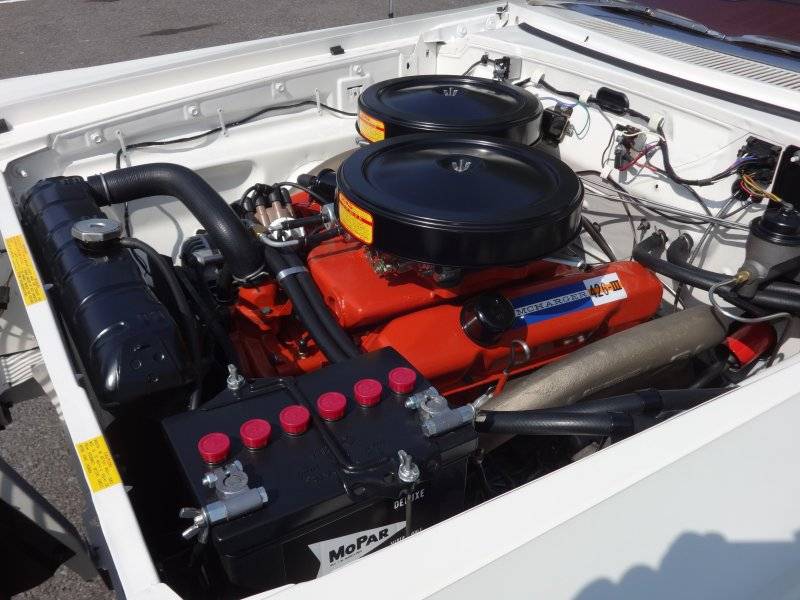

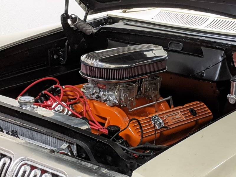

Downfall here is that '62 C-bodies retained the rear emergency brake drum instead of regular park mechanism. '63's were O.K.JMO I would locate 413 M/T from a 62 NY or imperial.
That way you could use the
push button trans.
Reproduction max wedge headers.
