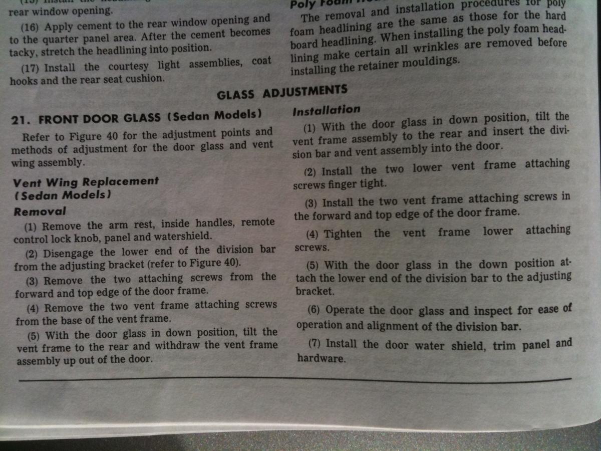

Seems like you have everything right... maybe it's stuck with dried paint? Here is the service manual page...

Ya, my 62 manual says the same thing.
