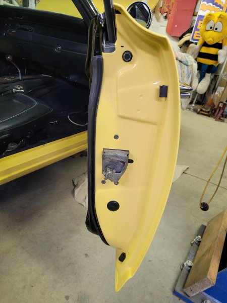

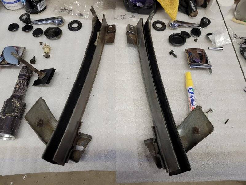

Front vent post needs to swing in at top, so the "foot peg" pin at the bottom of the door shell needs to go outboard and the two nuts in the front face of the door shell need to be loosened and pull the vent frame in. That may also fix the rear, but if not the rear window guide channel needs to be tipped accordingly. Again a slotted bolt in the rear face of the shell.
Pictures of the rear guide to give you an idea how it adjusts. The adjust "slot" bolt on the lower end is accessible through the lower black body plug.
