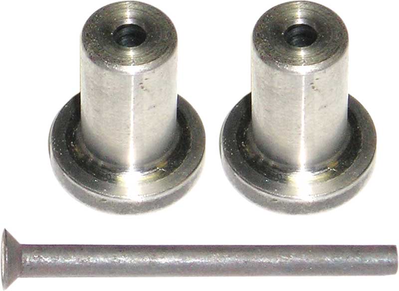

The thrust spacer kit is a pin type, like this:
I know that i can't use later non tapered axle shafts, i have tried this :-(
But is it possible to use the later diff type (68' CHarger 742 case) without problems? Do i only have to reinstall the thrust block pin set like on the pic and then set the end play using shims? Sorry if i don't know the exact names of the parts. Where can i get new shims from?

If the '68 742 has the hole through the pinion cross for the thrust pins, just go ahead and install them, and you're set. I needed shims too, but was not able to find a source, so I made them myself.
