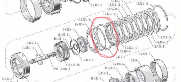

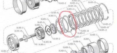

came across something today i was told that i needed a wavy spring clip and a plastic washer and a new plate, all the new books show theses items in order, but when i took it apart it onl had a thick spring clip, and the 62 and up book i have shows it with just the thick clip.the way mine was when i took it apart.... whats the wavy clip and the washer do...
in the intermediate drum, you will find that the wavy clip and the "washer" (which can be steel or a brittle plastic type piece) separates the belleville spring from the lower clutch plate (see picture attached). The purpose of the wavy clip and washer is to retain the belleville spring at the appropriate position above the piston so that the lower clutch plate may rest on it, and when the drum's piston is under pressure and expands, it pushes on the belleville spring (which is being held in place by the washer and wavy spring) and the spring is compressed thus causing equal pressure to be applied to the lower clutch plate, thus causing the clutch discs to engage (creating friction)... going into gear :D

i see but my book pic doesnt show that wavy clip or the washer, there is no way that wavy clip will go on with that washer.... i got a new washer, and wavy clip....what if it goes back togeather like it was....but with the wavy clip and no washer, insted of just the thick clip like before...
I will be honest i have rebuilt many 727s but never a pushbutton 727. What u have and what the OE equipment has could rightfully betwo different things. I would ask PBNJ 727 guys about this.

adjusted the kickdown band 72 in pounds backed off 2 turns and the other 72 in pounds backed off 3 turns per book specs...what it that wavy clip didnt hold what would happen
if it didnt hold then the intermediate clutch would not engage the clutch discs to put it in gear.. instead they would ultimately burn up due to excessive slippage.
