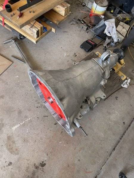

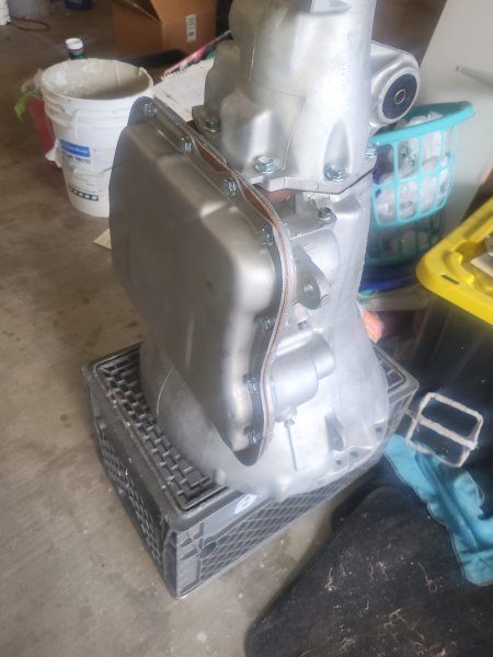

That is funny. I told my wife last night I’m pretty sure that stuff is just Vaseline. All of the cuts on my hands have pretty much disappeared. Very cool. I wish my case would have cleaned up that well. It is a complete 180 from what it was at the start of this. Made some progress today. I air checked the clutches. Both engaged and disengaged. I turned my air compressor down to 40 psi for the test, and if I left the air going to it I could hear a small amount escaping. Is this normal? Everything is assembled up to the clutches at this point. Then we had some company pop in so took a break When I went back after it was trying to play catch up with time and when prepping the front servo I snapped the smaller original ring since I was in rush. Then noticed my kit had only a plastic one. I wasn’t happy with the way that one seemed to fit so hoping the local transmission guy has a metal one or can get one along with the fiber washer that goes behind the stator. Also the nut on my neutral safety switch left its innards on the threaded end of the switch. So hopefully he can get his hands on a single prong switch. I bent the prong a little bit when was trying to get that gutted nut off and the transmission was still under the car. I had planned on just cleaning the threads out. Thinking now I should replace the switch.
We have everything bolted back up just waiting on the new neutral safety switch which should be on my porch today. Hopefully get it on the jack tonight or tomorrow night and bolted back into the car. After I do a little work on the engine since I have it up in the air to take care of some leaks and get a little cleaning done should be able to test it out in another week or so and see how I did. Thanks again everyone for the tips/advice. This went way smoother than I had planned. Now just hope I didn’t miss anything. I did air test and everything seemed to be working and no extra parts. So fingers crossed. Then I get to clean up my mess.
I'm sure you did fine. They really are simple devices as long as you pay attention to each of the assemblies and ensure the seals go in correctly. An air test let's you know if you are good for the seals.
Finally got the last bolts in this project. Most of my leaks seemed to have cleared up after changing the pan gasket and cleaning up and resetting the valve cover on the driver side. Replaced a leaking freeze plug too in the back of motor on the drivers side. That was pretty nasty in there got it cleaned out pretty well I think. Took it for its test drive last night. Took it pretty easy on the old fella and shifted through gears noticeably better. Everything engaged instantly and seemed to stay that way for about a 20 mile trip. So hopefully get some more miles on this week in the evenings and over the weekend hope everything stays working like it should. Definitely seemed peppier at the launch too. Big thanks to everyone with the tips and links. Made the process much easier!
