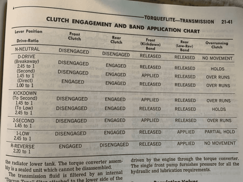

I takes about 3X the hydraulic pressure to operate reverse than the forward gears, so pump is working fine. What DVW said.
So I think I can check the pistons by dropping the pan and valve body correct?If it has no forward gears there would be 2 prime suspects. #1 Rear clutch failure, piston seals or frictions worn. #2 Stripped front planetary splines where they ride on the output shaft. Both will result in reverse working with no forward gears. I've seen both of these failures. You won't find either of them with a pressure check. Both require disassembly of the transmission.
Doug
There is no real pressure check for the clutch pacs. Only line, front servo release, rear servo, and governor pressures. As you can see in the chart the rear clutch is the common component applied in all forward gears. Air checking the clutch pacs withh the valve body removed only lets you know if the piston(s) are moving. Worn frictions won't show up by using this test. When the diaphram spring breaks, it normally jams up the rear clutch. But it is possible that if the spring broke, the pac may have enough travel to unseat the piston in it's bore. The rear clutch drives the front planet annulus. That leaves the front planet carrier either being held or driven. If it slips on the output shaft (stripped splines) those two functions can't happen.Before you tear it apart start with some diagnostics. Get a pressure gauge and a factory service manual and do a pressure test as outlined in the manual before dropping the pan.
This could/will point you in a direction. If the car isn't moving and pressures are good drop the pan and inspect. If it backs up and not going forward the rear clutch pack is probably the issue but always diagnose first.
