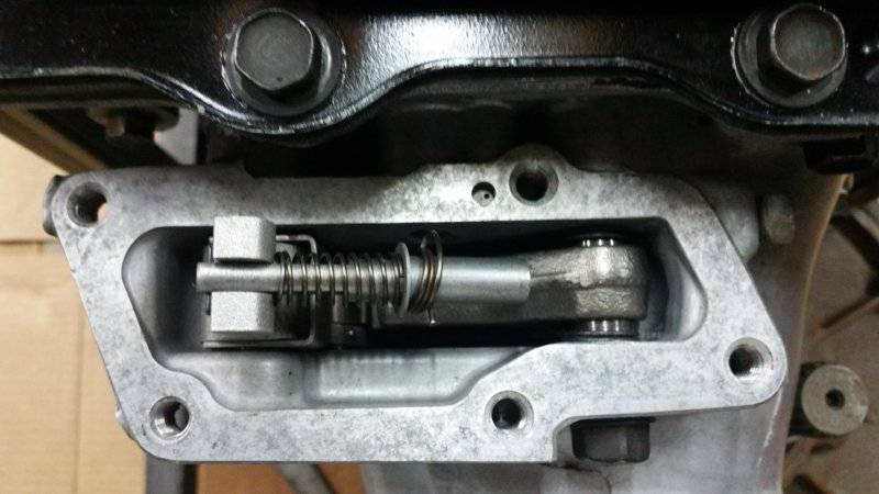

As far as removing/reinstalling, you loosen the bolt going across the cable you can see in your pic and tap it back a little (Do not lose that bolt you will hate life), then take the pipe plug out of the bottom of the cover, some fluid will come out but not much.. less than a cup. The end of the cable goes into a receiver and is held by a spring, you push up on the spring and the cable will pull out. I would put a new o-ring on.. i have heard of people epoxying or heat shrinking where the cable end meets the outer cable cover.. but no help there, got lucky and mine doesn't leak.. I also use RTV on the cable when when i put it back in.. so it's hopefully better than just the o-ring...
Here is a thread showing what it all looks like so you have a better idea...
Couple of other quick things, don't try to remove the cover with the cable still attached, people do that and it will make problems... On mine the spring the little end of the cable goes through wasn't holding when i put back together, i had to bend the spring a tiny bit so it held better. Now i check that before i put it together, takes 30 seconds and is easier than taking it back apart to fix that. (Just mentioning in case it happens to you)

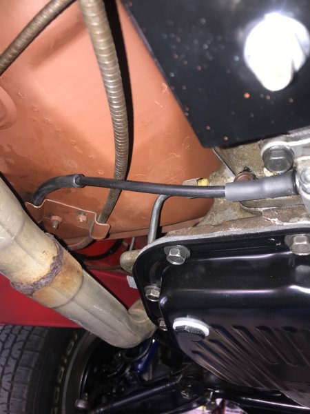

I have the same leak. On mine, the park cable came out of the holder on the floor pan and got on the exhaust which burned the sheathing around the cable. It runs down the cable at the burn and leaks where yours does. I am going to remove it and try putting heat shrink around it. Waiting for good weather, I'll let you know.

I removed my park cable from the push button mech at the dash and fed out through the firewall. Easy to do compared to fanagling with the spring holding the cable where it inserts into the transmission. Slid the heat shrink over the end and butted up against the transmission. Put 3 layers on as there was some damage on the original sheathing.
