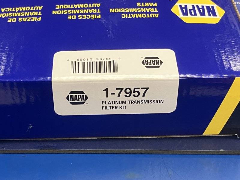

I've messed with the throttle pressure linkage (kickdown) but it doesn't seem to make a difference. It has been awhile since I changed the ATF and the filter so I'm going to try that. The fluid level is on the mark.

Does it just stay in 2nd? Or act like its in neutral when it tries to make the 2/3 shift. I'd get some pressure readings before changing the fluid. Very doubtful a fluid change will help. In 3rd gear you should see line pressure (50-90 depending on how much throttle) on the KD servo pressure tap (very front tap). This port reads forward clutch pressure. This pressure pushes on the KD servos release side while apllying pressure to the forward clutch. Also check governor pressure (tap is in the tail housing). It should be roughly 1 psi/mph. I have also seen cracked valve bodies. But not for this issue. In the 45 years I've been doing Torqueflites ther have been 2 with cracks.

I was all ready to pull the pan.
