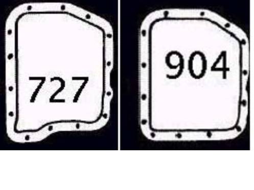

car orig. came with a 273. I assume the 904 is original. Later, a 1976 318 block was installed. Then i became the owner. For sure its a 904 based on pan.
Ok that explains it. Wonder what torque converter they used?
2801535 will be the original number stamped on the drivers side pan rail.
