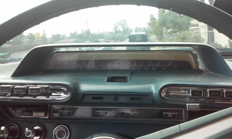

20150221_110221.jpgI wanna take aprt my cluster to get to the speedometer what would be the first place.to start?
[Oops, just noticed this was April of last year]

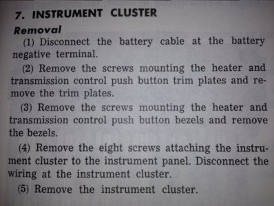

Pull the bulb sockets, the 2 screws on the pushbutton bracket and heater controls bracket, and disconnect the harness to the gauge panel below. Pull the gauge panel forward and rest it on the column.
