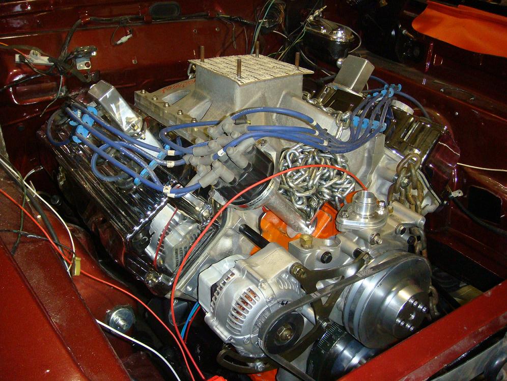

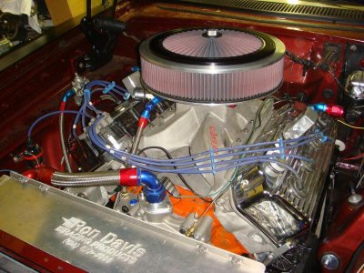

You can use the later model k-member in the 62-65 cars. I do it all the time. In fact, the first thing I do is remove the original K-member and install the later model unit for several reasons:
1 I moves the engine back (the originals sit slightly forward anyway) and there is no modification to the firewall required.
2 It gives you more room to run a large radiator and fan assy if you desire.
3 It allows the use of the later model "captive" idler arm, which are far superior to the early model arms.
4 You can run later model headers of which there is a much larger selection. A lot of the early pipes went thru the frame and, if I'm gonna spend money on new TTI's, I'd opt for the later units that have a broader sales base should you need to sell them later.
5 I've yet to have to hammer a firewall in my cars using stock-type valve covers, though I understand that others may have experienced it. The key is how you rework the trans crossmember to accept the slight set back.
All of my k-member swaps were done with a Hemi, and the Wedge is much easier to fit. In the 2nd pic you can see where the pass side vc rubbed the firewall during installtion - but it did not require denting.
Also note that, if you run the big super stock pan (dual oiling), the pan will drag over the k-member during installation. My current project is getting the relief cuts to the k-member (with reinforcing) to eliminate this slight interference. Stock pans and most Milodons fit with ease.
Here's a couple pics of a '64 I recently did - with aftermarket valve covers.

Thanks man! With the info you've put up it seems I'm good to go!
Thanks for the offer on the K, but I'm gonna go with my 67 K member as I had it blasted already, its solid as a rock and already painted for installation. Doesn't have the captured idler arm but I'm OK with that.
I was wondering about the firewall as I'll be redoing the cowl area anyway so IF modifications were needed, now would be the time to do it!
Happy to know I can leave it alone.
Man...that HEMI sure looks the part in there!
Thanks again...:D
