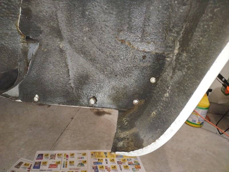

Thanks for your reply. I have attached a picture of the right side wheel well. I had already removed the 4 screws at the bottom before posting the initial thread.
If you blow the picture up, it seems like there are two dark colored pin nuts above the upper right screw. Are those dark colored nuts what you are talking about?
Also, it looks like my panels have some type of coating material on them. Was this normally done back then?

Factory undercoat.you can loosen with a heat gun and then scrape with a putty knife if you choose.
Sorry cant see the nuts. You can remove that splash panel after finding all the attaching bolts under the undercoating.
Try to see if you can look up between the splash panel and fender to see the back of the light housing.
You may be able to reach up in there to remove the nuts from the studs.Hopefully they are not too rusty.
Mine stripped and or broke off when trying to remove them.

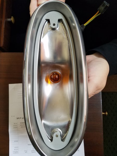

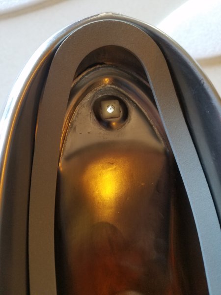

Had tons a fun with the park lights when restoring my ride. Good thing it was a CA car. The splash shields give good access to take the housings off. What was most fun, not, was finding the correct size inner and outer gaskets. Wondered if ma mopar had different sizes depending on what day of the week it was. Hard to believe what I encountered. Included a couple of photos. At the time could NOT find any new outer gaskets and what I purchased used were WAY off on fit. Ordered the inner's from another source to obtain a proper fit. My light assemblies were fine after clean up so no interest purchasing new ones for big bucks having the gaskets. Hope this isn't the case 4 years later. If not I'd like to hear. I cut and installed to find a decent fit; but if available now would like to change.
Ran into problems installing LED's in the front, all good for tail lights. Put in an LED flasher. The fronts would blink but only BOTH at the same time. Original bulbs worked fine. Did some grounding experimenting to no avail, so moved onto other pressing re-assemblies since bright rear lights and brakes were most important to me.
