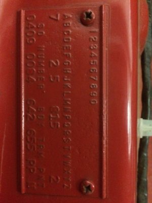

Hello everyone, I have some of the information off this tag but I just can't seem to fill it all in I'm missing some stuff. If anybody wants to take a peek and tell me what you think? Looks like a Lynch Road car to me 383 4 Barrel HP, special order, heater, red on red. Not sure what the 7 under B is or what rear is in the car? I've had the car for a long time going to restore it here soon. I know it has the original drivetrain and it still has the big block and 3 or 4 speed? And it's a January car I believe from the tag, so I would assume 3 speed? Any information would help thanks a bunch in advance! Here's a picture! 63 sport fury
Your car's scheduled production date is July 13, not Jan. If your car is a lynch rd. car( 4th digit in v.i.n. is a 1) then it is a 383 four barrel car with a borg warner 4 speed trans. The body code on the rad support should match the s.o.number on the fender tag.
The SO number is the shipping date. There isn't any "confidential" numbers until 1968. The number on the radiator support is a body code on these cars and it doesn't match anything on the fender tag.
The s.o. number is part of the body codes from1962 until1968. In 1969 the body codes contained part of the v.i.n. The first part of the s.o. number is the scheduled production date. In this case the first four digits.
Well that would make sense, the Vin starts 343112. So what rear any idea? I'd assume something sure grip, since someone ordered the car like this? Buy the way thank you as well!
I don't believe rear end codes appeared on fender tags until 1967. You would need a build sheet to confirm what the car came with. Your body code should read 31 0713 1648

The 5 under the A is sales code (505) 383 1-4bbl HP 330 horse power
The 7 under the B is sales code (347) 4 Speed T10 Floor Shift
Does it have the hump on the floor, floor shifter, or is it a column shifter?
A is the engine code
B is the trans code
They use the last number of the three digit code
Don't have any info for the F
B is the trans code

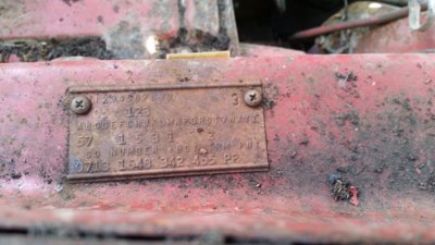

I would add the words 'Supposed to be' or 'Most of the time' to any and all statements being made related to any option decoding and date coding of Mopars. There's ALWAYS exceptions to the rule and that's just how Mopars were built. This is a photo of my tin tag. It's a 330hp 383HP with a Borg-Warner T-10. It was built with an open case 3.23 gear and not built with Sure-Grip. It was built in Hamtramck. There is a 7 under the A code and there is no number under the supposed to be transmission B code identification stamp. My car is a early 63 build (block casting is January 1963) as it has the 2206324 (4-bolt valve cover) heads. Later 63 cars were built with the 2206200 (6-bolt valve cover) heads. I don't know if the 2206 part of this casting number is correct but the last 3 are 2-0-0 for sure.

On a Hamtramck or LA built car the A is the trans code and the Q is the engine code I think. Lynch road tags are always different.
Correct.
The 7 under your A is for sales code 347, 4 speed, T10, floor shift.
The 5 under your Q is for sales code 505, 383 1 4bbl. 330 hp.
