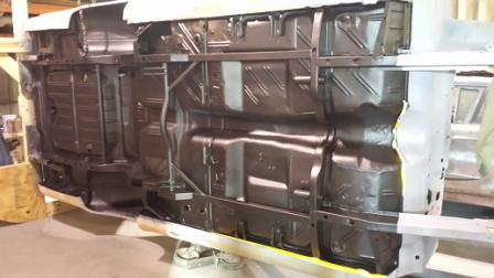

Flipped the car over today using a homemade tip over jig. My friends dad that runs the body shop laughed when I walked in with the wooden jig, he's now a believer......lol! It's just physics. Jig cost $90 and I can either reuse it or toss it when done.

all done!
Making steady progress. Bottom is all set.

Whatever works. We built a steel one from a couple of engine stands and a harbor freight worm gear when we built our wagon. It was amazing for crawling all over the beast and eliminating the 100+#s of undercoating.
