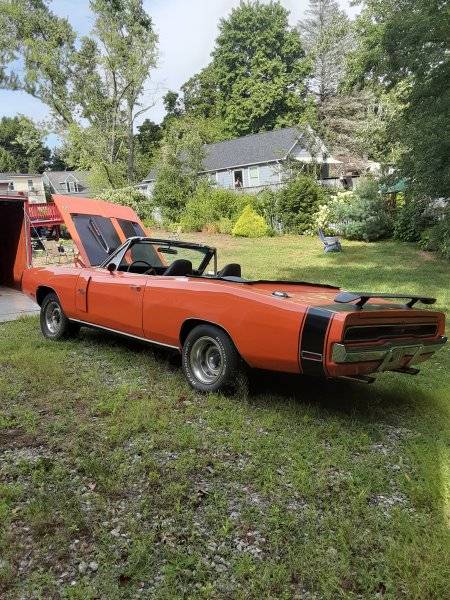

As I was washing the 72, I was thinking I should have come up with a name for it by now. I just call it "the orange car". But when I built it I wanted it to look like a mix between The General Lee and Daisy's car. Then I thought "well it IS generally Daisy's car"....
"Generally Daisy". I like that.
Blessed to have my dream cars. I just hope they fit in the next garage...
You don't realize how much stuff you have collected until you have to move it! The Plymouth is lookin good!
I have a few names for some of the cars,the Chargervert is known as Orange Sunshine (from my high school daze) the yellow 70 Charger is known as Yella Flash from the movie Dirty Mary Crazy Larry. Did a Dodge Charger do that? Well yeah, I think so, all I saw was a yella flash! My white 70 Charger is White Lighting, and the black 71 Charger is Sinister. Blue on black might be a good name for the convertible 71 Challenger. That might be appropriate since Kenny Wayne Sheppard is a Mopar guy too!

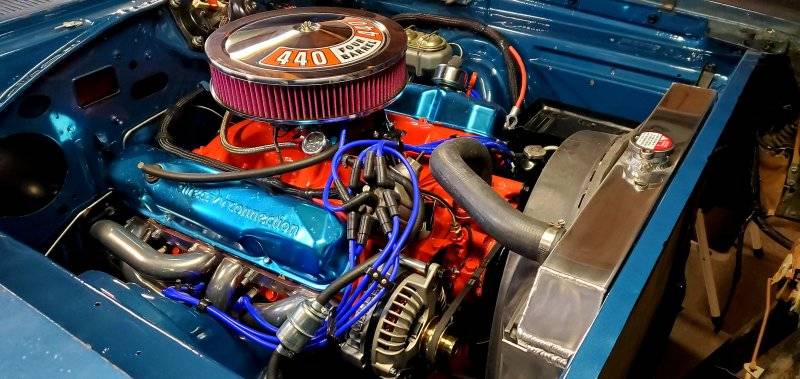

Pulley showed up this evening so I got that installed along with the cooling system. We're just a belt, a battery, some fluids, a prime, and some brake bleeding away from starting it up.
Got the battery in, belt on, rad filled, 5 quarts in the trans, master cylinder bled, and started bleeding brakes with the help of a neighbor.
The battery and belt fit perfect, no issue. Everything else though... lol
Filled the cooling system and the water pump is dripping. The pump I bought had a sheet of paper in it that said the way it was made it could leak right off the bat but once it's run, it'll stop. Let's hope so. Just a small drip into a clean pan.
I started filling the trans and the dipstick tube is leaking. I only put 5 quarts in and have a deep pan so I guess I'll let it drip until the level goes down enough to pull the tube without dumping **** everywhere. Then I'll replace that o-ring or just put some rtv around it. Idk.
Bugged a neighbor and had him work the pedal while I proceeded to find all the brake lines I apparently didn't tighten enough. Damn SS lines always seem to need Herculean strength to get them to seal. So anyway I found several leaks, tightened em up, found others, tightened those, let the neighbor go home, and I hosed down everything that mightve gotten brake fluid on it. Will try again for brakes tomorrow. Should've done it before the engine, I know. I messed up.
Anyway, it'll get there.

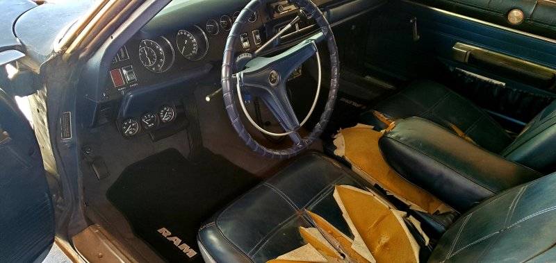

I "finished" the wiring the other day (I'm losing track at this point) but didn't start testing stuff until today. My wife was inside bitching at the cable company for hours on end so I wasn't going to be in there for THAT so I stuck a battery in it and started looking for smoke and listening for the sizzle. Neither happened. Whew! Relief. Turned the key, fuel pump kicked on. Turned it off, pulled that fuse so I don't have to listen to it. Turned the key, I got headlights, hi & low, tails, brakes, blinkers, flashers, courtesy, horn, CB, cranks, etc.
What I noticed I didn't have was dash lights or gauges... This is the part of the harness that was kind of confusing for me the day I did it. The AAW harness is great but the "instructions" are my least favorite of any harness I've ever done and the last thing you need to do when you are rewiring an entire car is: Get frustrated and keep going. Fuckin stop. LOL. Just stop. Go fishing. Bang the ol' lady. Something. I kept going. Anyway I screwed up and had to drop the column and pull the cluster to see what I could see.
About 30 min in I tracked down the gauge issue to a connector. Say it's a 6 prong connector but only 5 are used and I put the power feed in the dead spot. That was easy enough to fix. Now the gas gauge moved, but the temp gauge pegged out. Hmmm...
Well then I figured I'd try to track down the dash lighting issue. And that's where I screwed up AGAIN. I pulled the seat and spent hours checking and rechecking. Tried grounding the cluster differently. Nope. Couldn't find **** wrong.
At this point I'm like "F it", it's 9:30pm she's got to be finished hollering at her phone by now and I went inside. Shower, food, hung out a few then she went to bed, and I think "what if that dimmer is bad"... You know. The thought I should have had hours ago. So I'm out there in my robe, laying in the car digging under the dash. Made a jumper and pinned the 2. Took 5 minutes. Dash lights work. Bad rheostat.
Well they "mostly" work. The printed circuit board lights were not working. I put LEDs in everything in the dash and remembered some guys saying they had to turn/clock some of theirs to get them to work so I tried that on one and nothing. Then I turned the key to acc and the circuit board light I just turned around came on which is weird. Not right. It wouldn't come on with the dash lights. So about half the dash lights work currently.
Anyway I've still got one or two things screwed up in there. I beat myself up over screwing up but it doesn't do any good because I definitely WILL screw up again. I'll figure it out. It's like they say "If it was easy, everyone would do it"
If anyone has any ideas, LMK. I appreciate you guys. We're getting there.

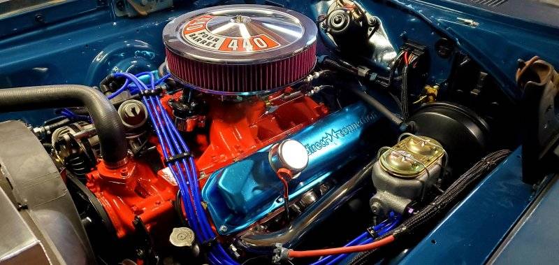

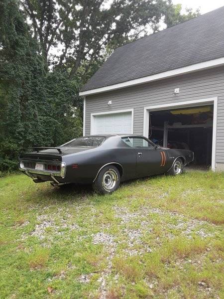

I found my priming tool and a buddy came over to buy my air compressor so I enlisted him for an hour and the car fired right up. Starts up and runs fine. I've got to get these brakes fixed so I can see how it acts under load. A few things to check and recheck.
I fixed the dipstick tube leak then the dipstick itself broke . The "finger ring" snapped off. At least that's just 1 step forward and 1 step back and the step back doesn't involve trans fluid pouring all over the ground. Got to look at the bright side I suppose.
Cliff came over and hung out for a while too. He was excited, hadn't seen the car since he sold it to me a year ago. He took pictures and climbed all around and in it. I told him to go fire it up and he hesitated but went and sat in the seat. He sat in the seat of his old car and it fired right up. He talked about how he loved the sound of that cam, how the old seat somehow felt softer than he remembered it last, how nice it was to see floors back in the car, how he always dreamed that the engine bay would shine like it does now, how he used to try to wax the engine bay to shine it up but it never worked , and how he didn't like the stance. He always wanted the car so sit super low like a nascar car. Can't win 'em all I guess. I should have got another picture of him with it...
I'll contact the original owners family this week because they all want to come see it as well before we move.
